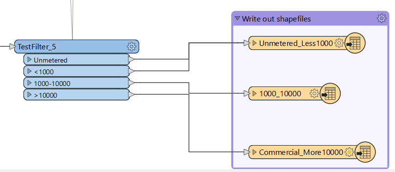

Hi all,
I am working on a translation in FME, and I’m encountering an issue where my data is being fanned out to multiple locations. However, when FME tries to write the shapefiles to the first file location, the translation stops without any specific warnings or error messages, other than the general "Error running translation."
Interestingly, on FME Flow, the process behaves similarly. It doesn't throw any errors, but the translation simply stops after attempting to write to the first location, as if it's hanging or failing silently.
I’ve tried to troubleshoot by checking the file locations and permissions, but the issue persists. I would appreciate any guidance or suggestions on what might be causing this or steps I can take to diagnose it further.
Thanks in advance for any help :)

Can you try with a new simple workspace if you are able to write a sample shape file on the location you try to write?
sarah.h.a
Forum|alt.badge.img+3
  • Jan 29, 2025 3:05 PM UTC
I extracted the other shape files which have the same fan out settings to the same folders and no issues there.The ‘Unmetered_Less1000’ is the one that keeps failing.
