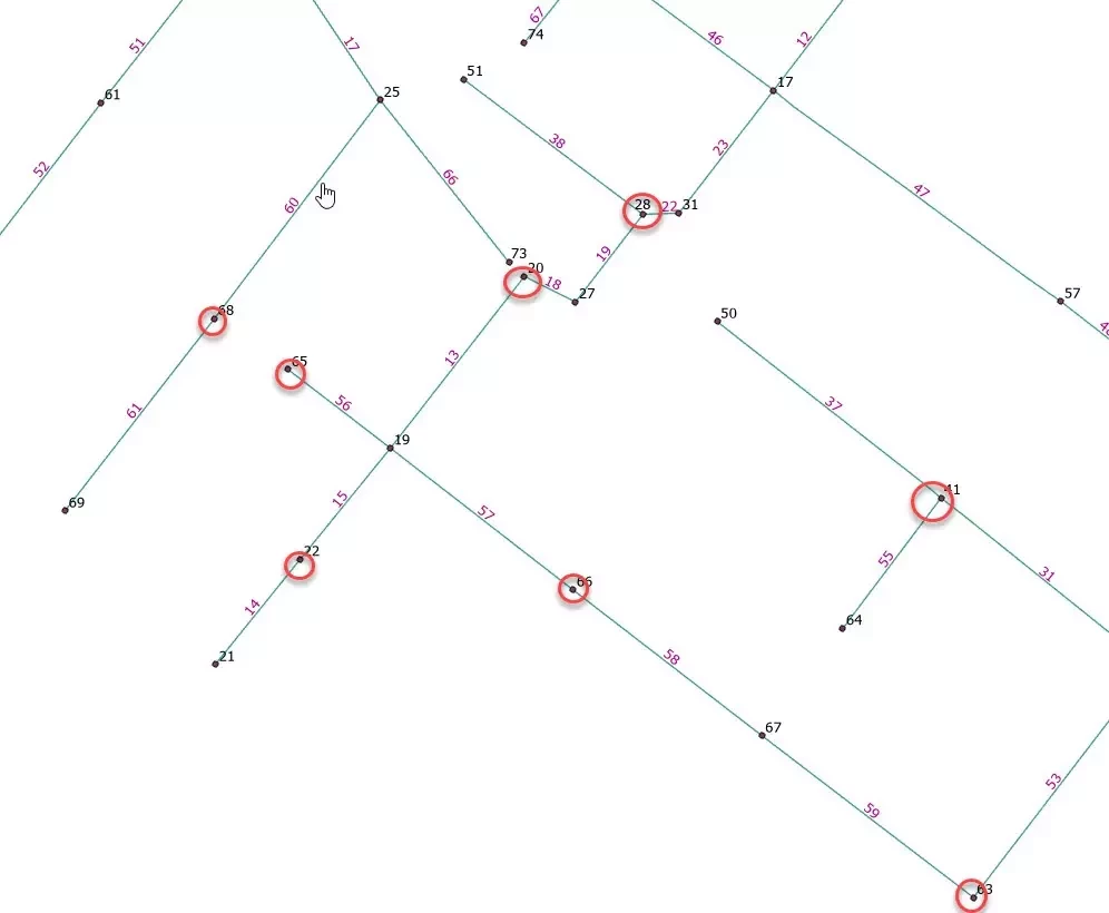

I have a network of connected points and lines, and I’m looking for a way to create a selection set of points along the network, the key being I want to only select every other point. I tried modular selection counts (odd vs even numbering), network topology build for start and end node, but I can’t seem to get the results I’m looking for.
Below is a screen capture - I want to eliminate the grey colored points in between. At intersections these points would be retained if necessary according to the ordering.
Select all points in Orange, skip points in Grey

By your reasoning point #27 should be skipped, right? Because I see it included in the result set.
And how do you want to deal with an intersection point which should be retained according to the ordering of one line, but not on the other?

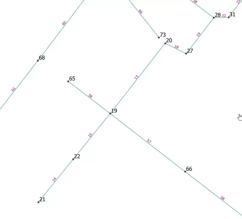

I included another screen cap, that hopefully clarifies; basically every other point, and somehow at an intersection I would have to calculate if a neighboring points were included as it branches out moving forward with the selection.
