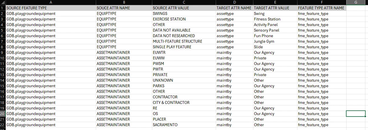

I’m pretty new to FME and I’m using FME Workbench 2024.2 to move data from my sde gdb schema to an Esri Parks and Grounds solution fgdb schema.
I’m having trouble with the SchemaMapper and moving my domains(attribute values) to the fgdb’s schema. Currently they are not mapping.  Previous SchemaMapper parameter settings moved the source attribute value over to the target attribute, but kept the same source attribute value (MULTI-FEATURE STRUCTURE should’ve changed to Jungle Gym but instead it stayed as MULTI-FEATURE STRUCTURE). Can anyone help provide more instruction on how to get the source attribute values to move to the target attribute name and change to the target attribute value?
Here’s the .xlsx I’m referencing

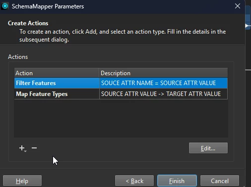

Here’s my SchemaMapper Parameters
