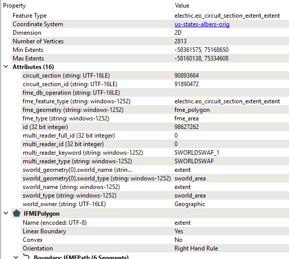

The geometry type is fme_area as shown in the feature information window below.

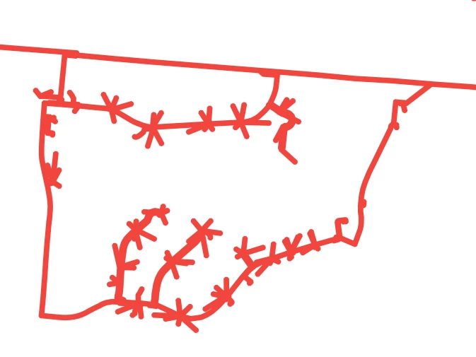

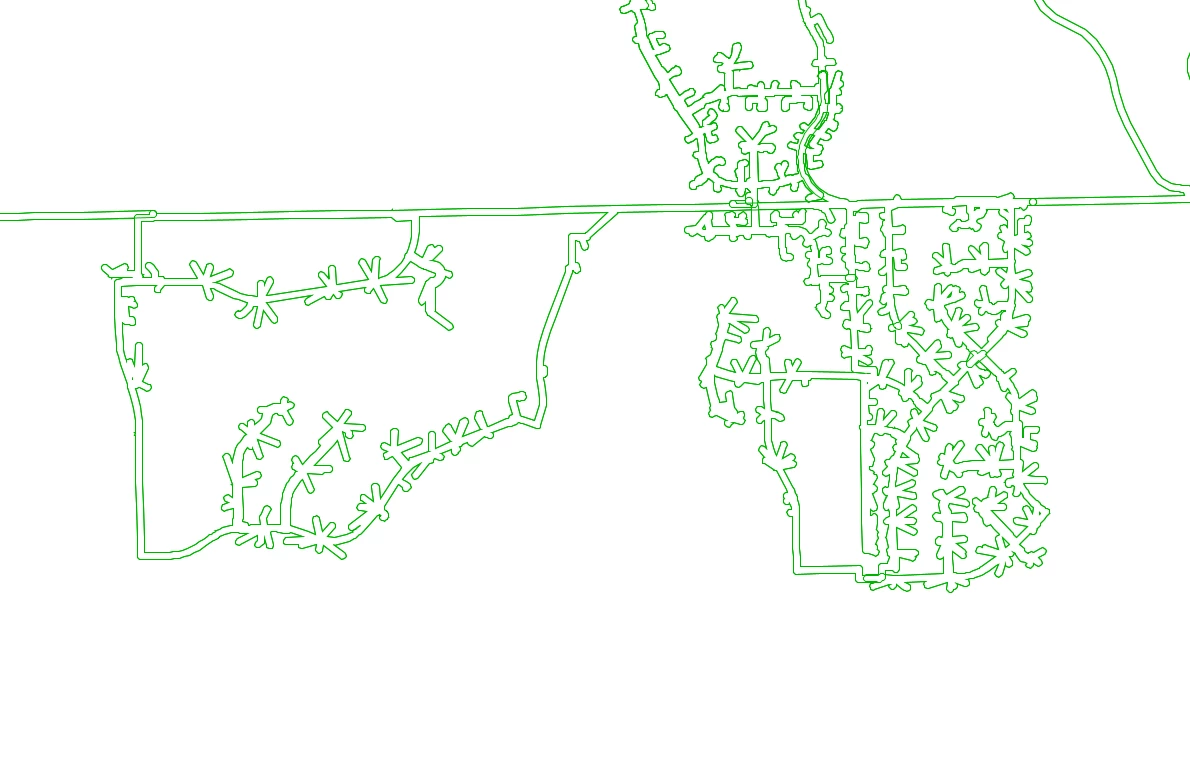

Here is the data viewed in Smallworld:

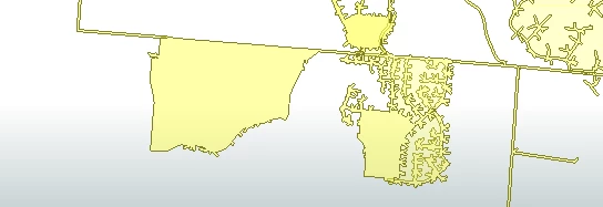

Here is the data when I inspect it in FME. Note the filled in area on the left:
According to the Safe Software documentation for the Smallworld Reader, Donut Polyons are supported. However, this geometry seems to be lost as soon as it is read into FME, and maybe there is not a way to restore it.
