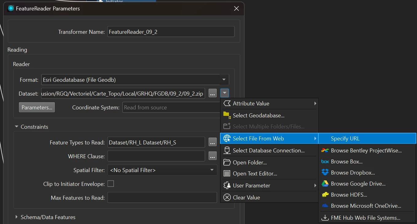

Hi,
I need to use many hosted GDB from the web. They aren’t in the same root folder, they all have sub folders.
Quebec Hydrographic Network Geobase
Is there a way I could use Multiple URL instead of having to use 15 FeatureReader, one for each GDB?
Or a way to download everything from the root folder ?
Thank you.

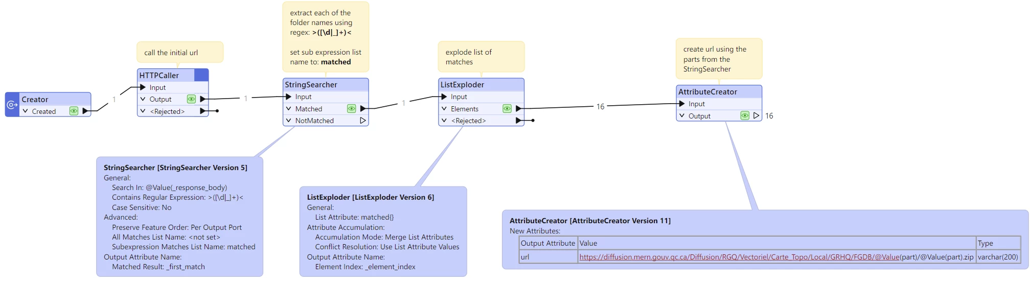

Best answer by hkingsbury
It looks like wild cards don’t work like they do with a file path (kinda expected that).
The naming of the zip files appears to match the folder they’re in, so you need to get the name of the folder, then can derived the zip file name and url from that. Something like:
hkingsbury
Forum|alt.badge.img+73
  • Jan 7, 2026 7:20 PM UTC

Hi! What’s your HTTPCaller parameters? Do you have something else than that? I can’t make it work.
s.jager
Forum|alt.badge.img+27
  • Jan 8, 2026 3:44 PM UTC
You need to add the / at the end of the URL to make it work...
