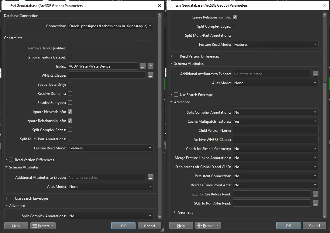

Sure, right now my Workspace is just a simple  FME’s Esri Geodatabase (ArcSDE Geodb), configured as follows:
My Workspace
Reader Parameters
