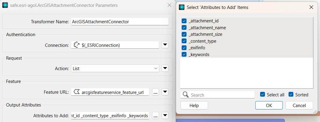

salvaleonrp
Forum|alt.badge.img+23
  • Nov 30, 2025 1:35 PM UTC
While still relevant for legacy AGOL format readers, the use of the GLOBALID from the attachment table is not needed when using the ArcGISAttachmentConnector. The connector relies on the format attribute _attachment_id for downstream action items related to attachments.
