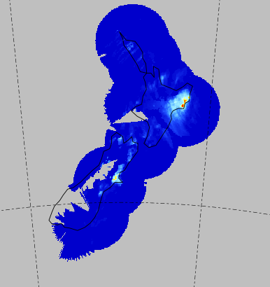

I have received a series of NetCDF files (representing rain radar) and I have no information on the projection for them, other than they are supposed to be in New Zealand and maybe Lambert Conformal? I can represent in an app like Panoply (image below) but when I try to project in FME, NZTM or LL84 is incorrect. I have tried creating a custom coordinate system but this is no use either.

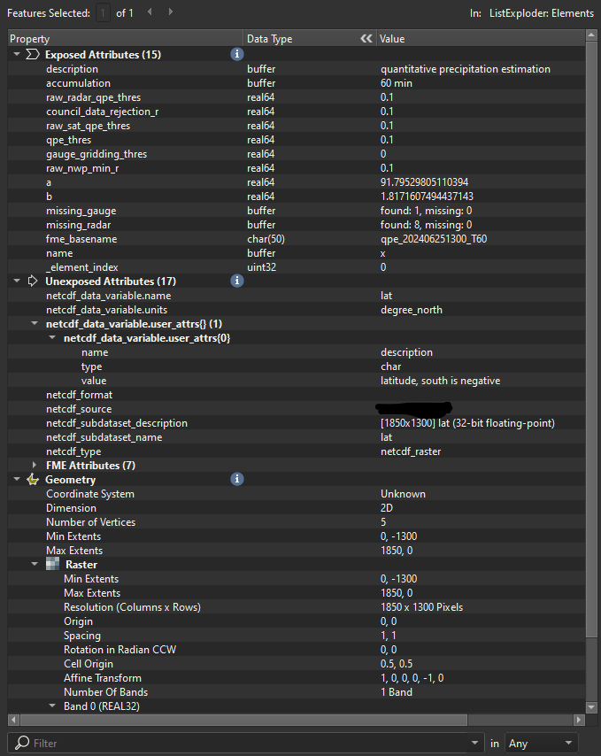

I’ve included a view of the Feature Information with the exposed list as per this conversation NetCDF - no CRS desposited | Community.

So each NetCDF file has a few features, of which ‘lat’ and ‘lon’ are present, plus the actual radar value i need ‘qpe_radar_adjusted’. See below. So i can combine these into a single raster to get 3 bands (lat, lon and qpe) - but when i try to project into lat/lon (as the name suggests) - its still being funky!
