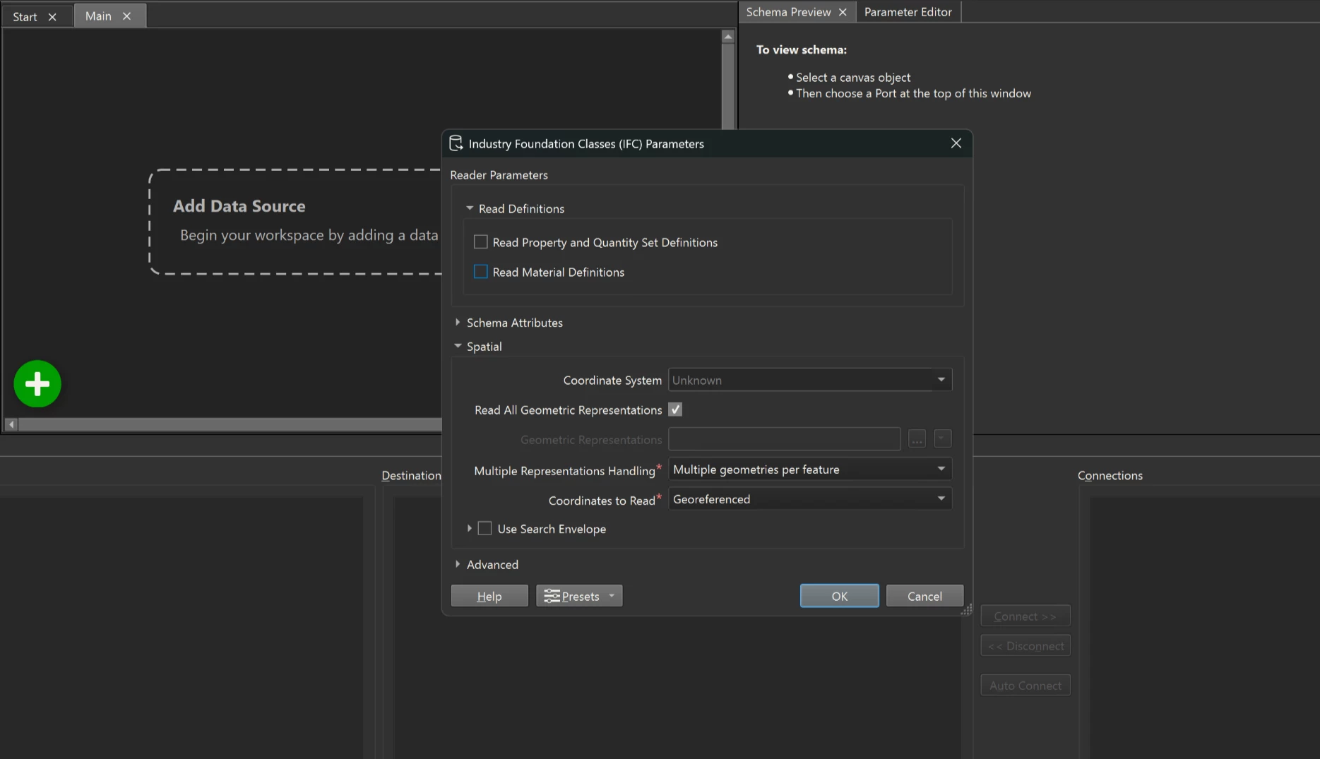

The IFC_API format underwent significant changes regarding property sets between versions 2025.0 and 2026.1.
If you do not need 100% round-trip fidelity, you will likely see a performance improvement if you uncheck the parameters in the Read Defintions group.
If possible, can you please share your workspace and some sample data with us?

Hi
Sorry, that doesn´t seem to help. I created a support request (65894) and got a reply from Dave. It sounded like this might be improved in a future release.
