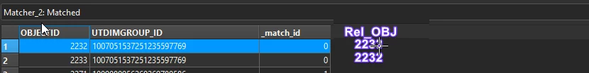

Now I want to create a new attribute rel_obj that stores the ObjectID of the other feature in the matched pair as in the image.
What is the best way to implement this in FME?

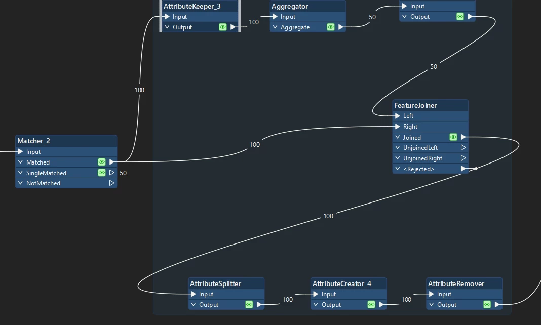

Now , I solved it like this:
I used the Aggregator to aggregate features and concatane the OBJECTID values with a comma and then joined the data with itself based on MATCHID.
After the join, I split the concatenated OBJECTID field, which is a list.
I then compared the elements of the list if an element is different from the current OBJECTID, I assigned that value to REL_OBJ.
