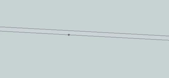

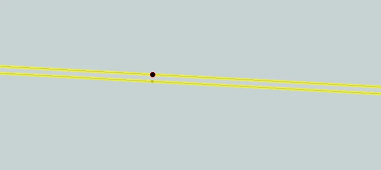

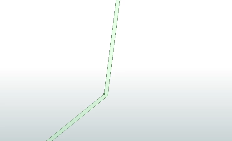

Is anyone else encountering  vertices that are not displaying when Mark Coordinates is turned on in the Data Inspector?
The coordinates are in the feature record, and display when I select them.
Currently using FME 2025.1
The features I’ve noticed this in have been donuts, and it’s the inner ring that is not appearing.
