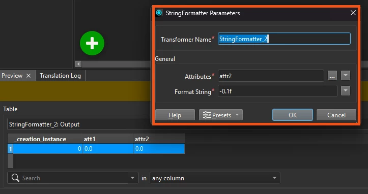

  • Try StringFormatter with format string -0.1f on both X and Y to force identical string representations.
