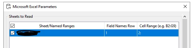

If reading from an excel file, you can select the field names row and the cell range

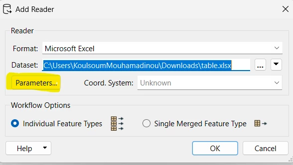

 Hi ​@aashnaparikh , when you add the reader, you can adjust this in Parameters.

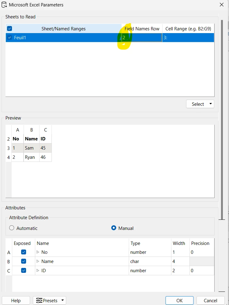

 Then here you can change Field Names Row from 1 to 2
And normally you will obtain this :
