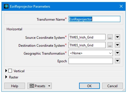

If your input data has the Irish National Grid TM65 set on it, it should not be necessary to set the coordinate system in the workspace - it will carry through from source to destination.
If the data has no coordinate system set on it, you can set it to EPSG:29902 using the EsriReprojector, by setting both source and destination coordinate systems to TM65_Irish_Grid:

Hi ​@siobhan_mcd great question, sorry about the confusion! You will need to make sure that the coordinate system is set correctly on all streams of your data before arriving at the writer.
if some data in your workflow already has the correct CRS then you don’t need to set it again. For those that don’t have a CRS set you can set it like in the screenshot Dave provided. If you need to change the CRS from one to another then you will need to reproject by setting the source to the data source coordinate system and the destination as TM65_Irish_Grid.
There are a few reprojection engines in FME. The EsriReprojector has the latest definition for TM65_Irish_Grid, you may not find it as an option in the others.
