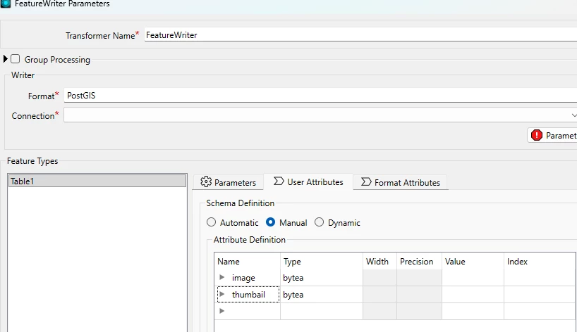

I want to write this table to PostGIS
I have constructed a table in PostGIS with the columns “image” and “thumbnail” both defined as bytea
How do I write the workspace that Reads from Oracle and Writes to PostGIS?
I made an attempt, but now FME fails to display the data from the PostGIS table, so there is something wrong.

Yes, you can write to a PostgreSQL/PostGIS bytea (BLOB) column from FME.
Either in the Reader to the oracle format, inspect the exposed attributes you have and check what data type they are? Tip inspect the data and use the Record/Feature Information window
optional, perhaps not for your use case: You may also want to look up more about AttributeFileReader transformer, pointed to the oracle ‘image’ and another to the ‘thumbnail’ reads.  AttributeFileWriter is typically used in the opposite direction (writing a blob attribute out to a file).
In the PostGIS Writer attribute definition, make sure you select the bytea type
