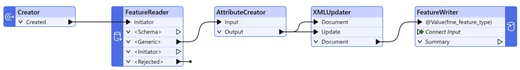

I’m able to update metadata elements in multiple feature classes within esri file geodatabases using the very helpful article at Working with Geodatabase Metadata: Writing/Updating Metadata – FME Support Center. This gets me most of the way to where I need to be.
After reading through the article and numerous posts on the Community, I’m stuck on how to use this or another workflow to update the metadata for the file geodatabase itself. There is metadata associated with each feature class, but there is also geodatabase-level metadata.
The FeatureReader using the Metadata Feature Read Mode was new to me - very useful, along with the XMLUpdater and the methods outlined in the article. But it seems to only work for the contents of a geodatabase.
Any thoughts on how to work with the metadata on the container, as well?

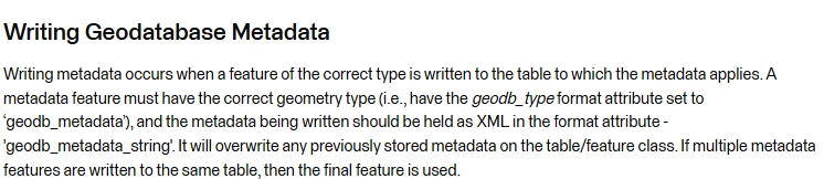

You used be able to control this on a writer parameter for Esri geodatabase. Now I think this has changed in 2026.1 fme, following this article Working with Geodatabase Metadata: Writing/Updating Metadata – FME Support Center
You may need to transform it into XML within format attributes using XMLTemplater, AttributeManager  set required attributes
  • geodb_metadata_string = your XML here
  • geodb_type = geodb_metadata
On a reader you can change the read mode over = Metadata

This is currently simple and effective for sanitizing a problematic metadata element (/metadata/Esri/DataProperties/itemProps/itemLocation/linkage) that is not editable within ArcGIS Pro or by exporting, editing, and importing the metadata, so a real security/privacy benefit to overcome a defect in the esri format and software:
User Parameters specify the feature classes to have their metadata updated and the metadata element replacement value.
In ArcGIS Pro, one can View or Edit the Metadata for feature classes within an Esri file geodatabase, but also for the file geodatabase itself. Since the geodatabase is not read in as a feature type, I don’t see a way to edit its metadata.
Hopefully that helps to clarify the issue a bit.
