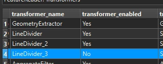

Not sure I understand the question completely, but can’t you use the transformer_enabled attribute when reading a FMW, it’s in the Transformers feature type? Or are you refering to the Transformers inside of a Custom Transformer?

Thanks for your reply.
For a transformer, you can see whether it is enabled or disabled from the attributes. However, when you check the Custom Transformer Parent attribute, the problem is that it doesn’t show the instance name, such as LineDivider_2 or LineDivider_3. It only shows LineDivider.
For example, if you have three custom transformers:
  • LineDivider
  • LineDivider_2
  • LineDivider_3
and LineDivider_3 is disabled, you cannot determine which specific Custom Transformer Parent is disabled because all of them are shown simply as LineDivider.
You could create a small workspace with a LineDivider custom transformer and then copy it one or two times. After that, you could check how the FMW Reader reads these custom transformers.
All of them will probably be identified as LineDivider. In custom transformer parent attribute  My question is: if one of them is disabled, how can I determine which specific instance is disabled?
About transformers inside custom were easy to get ,I have no problem with it .

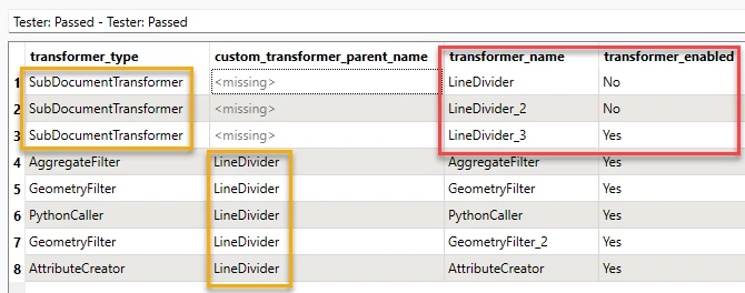

​@gogopotter90 I do see the instance name and which are enabled:
However, if the FME being read has more than 1 custom transformer and the transformer_name (instance name) doesn’t resemble the custom_transformer_parent_name then there’s no way to reference those instances with the parent custom transformer.

​@DanAtSafe
This is my main issue. As in your screenshot, you have an AggregateFilter transformer inside the Custom Transformer. I need to identify which specific Custom Transformer instance it belongs to — whether it is LineDivider, LineDivider_2, or LineDivider_3.
This is important because if the AggregateFilter is inside a disabled Custom Transformer, then it is effectively useless for me. I only want to process/reference transformers that belong to an enabled Custom Transformer instance.and I could not distinguish which linedivider is linedivider 2 or 3 in custom parent name and custom parent name show us only linedivider , but one of them is linedivider,linedivider_2,linedivider_3 .
Is there a way, perhaps using a PythonCaller to determine the specific Custom Transformer instance that each child transformer belongs to?

​@gogopotter90
You can’t know, because they are all the same, that’s why you create or use a custom transformer, to reduce the numbers of transformer in your workspace. In your case you need to “attach” the fact that all the transformer that are in your custom_transformer_parent_name are in each of your LineDivider, if your LineDivider is Disabled it means that for this instance all of the transformer are not active, but they are still active for all the others, but they are the same transformers.
If you have 3 times your LineDivider, it means you have 3 times a reference to the same transformers.
