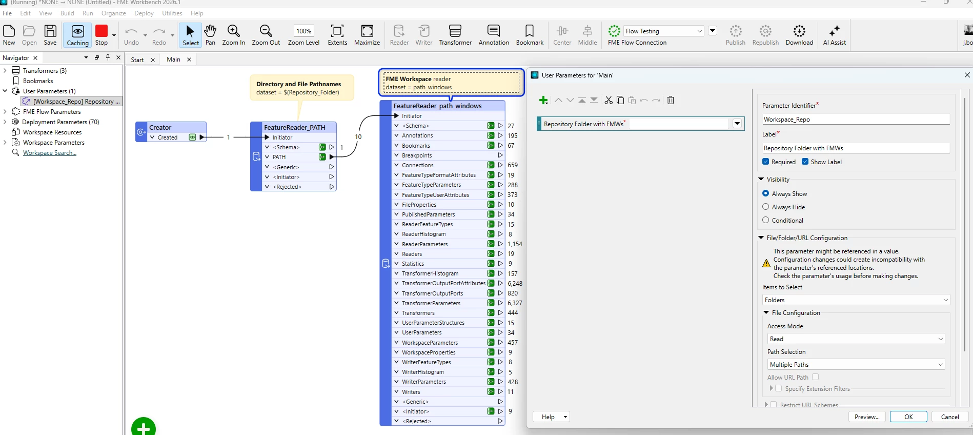

Simply build an FMW with two Feature Readers:
  1. Directory and File Path format with a filter for *.fmw, recurse into folders = yes and pass the path_windows attribute into a second reader
  2. FME Workspace format which has many output ports you can use
  • Workspace name
  • Readers
  • Writers
I would set the reader dataset as a User Parameter to provide flexibility to read other paths, e.g. network stored workspaces vs FME Flow paths
From here you place a Writer - specify the format (excel or csv) and where the output dataset is to be written
Publish to Flow, you can utilise the user paramater to re-use the workspace, pointing it to different repository directories

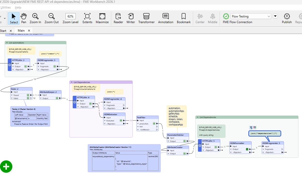

I would simply use the FME Flow REST API for this. It’s very simply to use e.g. in a workspace with a few HTTPCallers and JSONFragmenters et al. in them.
https://docs.safe.com/fme/html/fmeapiv4/docs/index.html
If you iterate over the automations and schedules, you can use the /dependencies endpoint to locate which workspaces are referenced.

thanks david_r, I managed to get the V4 dependencies endpoint working… below is just a scratch example and needs reordering...

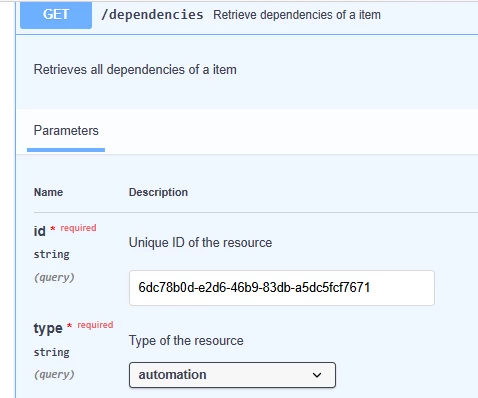

There are many type choices: automation, automationApp, galleryApp, schedule, stream, token, workspace, workspaceApp

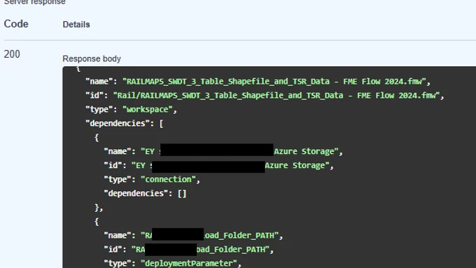

I am getting the same value for   a) name and b) id (2026.1 - 26103)
request
does this look correct?
response

Your example looks as expected, as not all Flow objects have an ID as such. Some of them (e.g. workspaces and deployment parameters) are referred to by name or repository+name. Some other object types are referred to by ID (e.g. automations), so if you try to list the dependencies of an automation you should see uuid-like values for the ID attribute of the automation itself.
