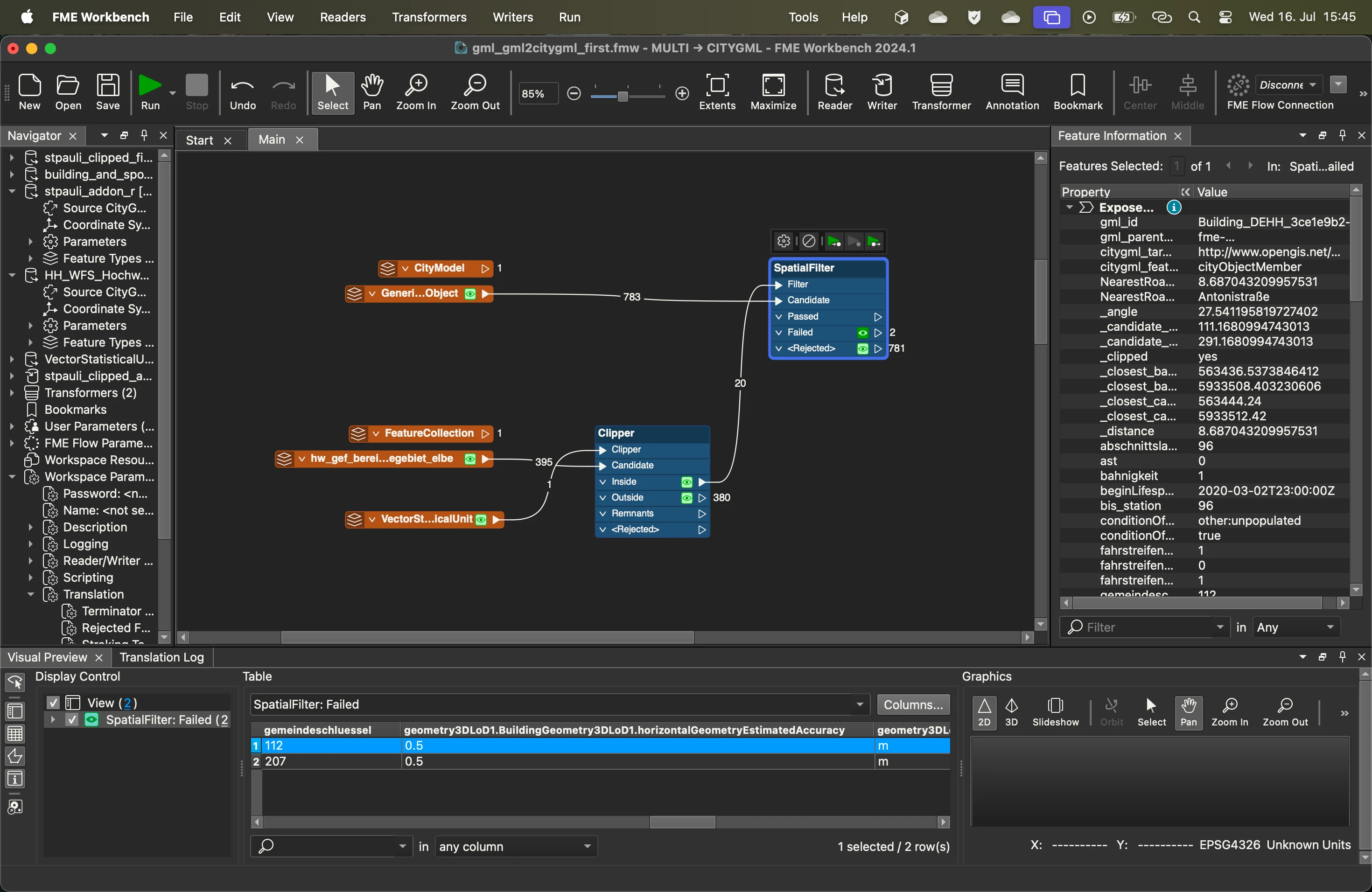

I’m working on a flood-affected buildings project in St. Pauli, Hamburg, using FME’s SpatialFilter transformer. I uploaded an image of my setup (see attached). Almost all buildings are being rejected, and I’m not sure why. My buildings are the "generic object," and the flooding areas are the clipped ones.

What does the fme_rejection_code on the Rejected Features say?

You may want to check your projections or reproject before using the spatial filter
