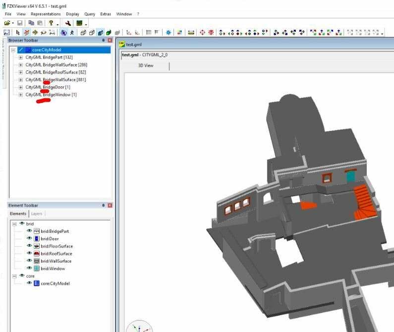

Hello, GML always writes a hyperlink at the beginning of the output, how can I fix this?

Hi @bayram
Are you able to explain or identify where the unwanted hyperlink is? It is not clear at this time.
Are you talking about the gml header at the beginning of the citygml file (eg. seen in Notepad++ for example)? In a gml file, the header is used to define the XML schema and namespaces that the document will use.
Alternatively, are you talking about the 'CityGML' prefix on the citygml layers in the FZKViewer? If so, I think this is a fault of the application. If you use QGIS to view the model, the 'CityGML' prefix is not present.
If you can help identify the exact issue, we can look into this further.
Crystal
