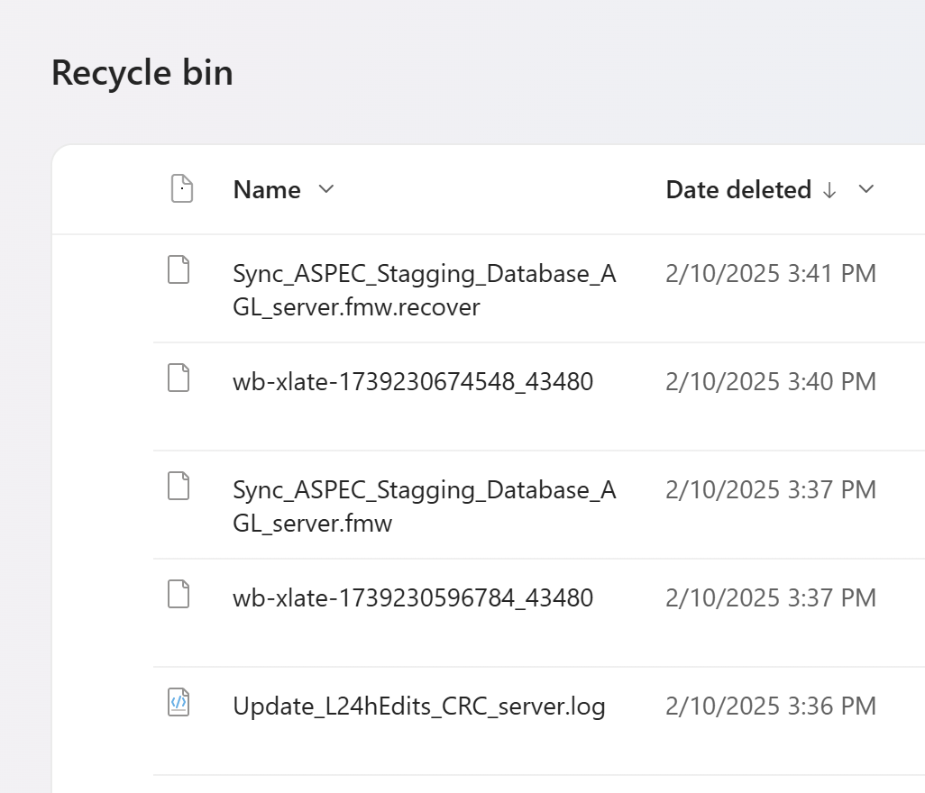

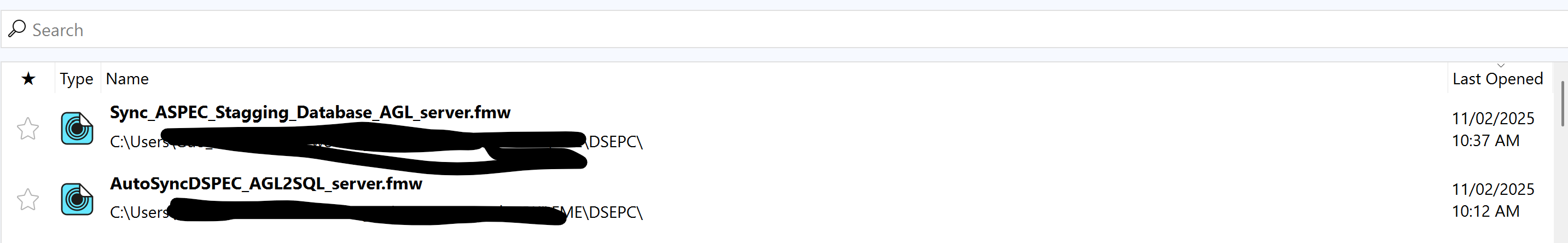

The issue happens again. What I did was upload the workbench to FME Flow then close the workbench. All .fmw files disappeared from the folder including recovery files.
Default save directory is set to: Last Workspace Directory.
FME Workbench welcome page shows my work history, and the file did exist in the same folder before.
I can find them in OneDrive Recycle bin.

Thanks for your reply. Yes, I did check. However, my case seems slightly different. The issue occurs in both local and OneDrive folders, so OneDrive sync conflicts are not the cause. Both the .fmw file and the recovery file were deleted, and I can’t recover anything without the Recycle Bin. And it's not just the file I edited that day—all .fmw files within the same folder were deleted after closing Workbench.
In most cases, this isn't a major issue since both OneDrive and local folders have a Recycle Bin for recovery. However, in rare cases—like when I first noticed the issue—the folder was on a network drive that only backs up every night. This means any work done during the day would be lost.
