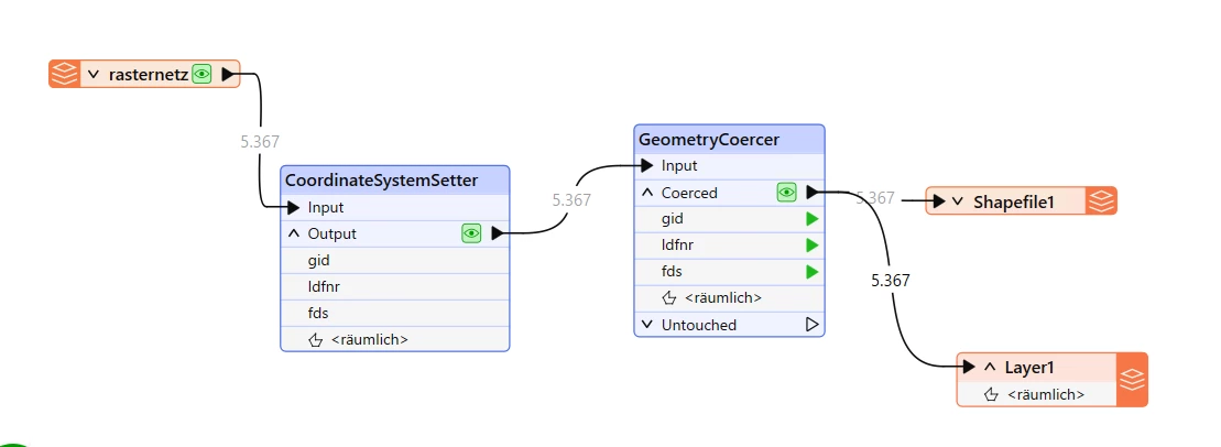

I show you the model attached in an image:
The shapefile “rasternetz” gets a Coordinatesystem (EPSG: 25832) and is changed from poylgon to line (via GeometryCoercer). If I transport that file to a NEW Shapefile (Writer) everything is fine (it is a line-shapefile then, has a coodinate system, all the 5367 objects are well shown in QGIS).

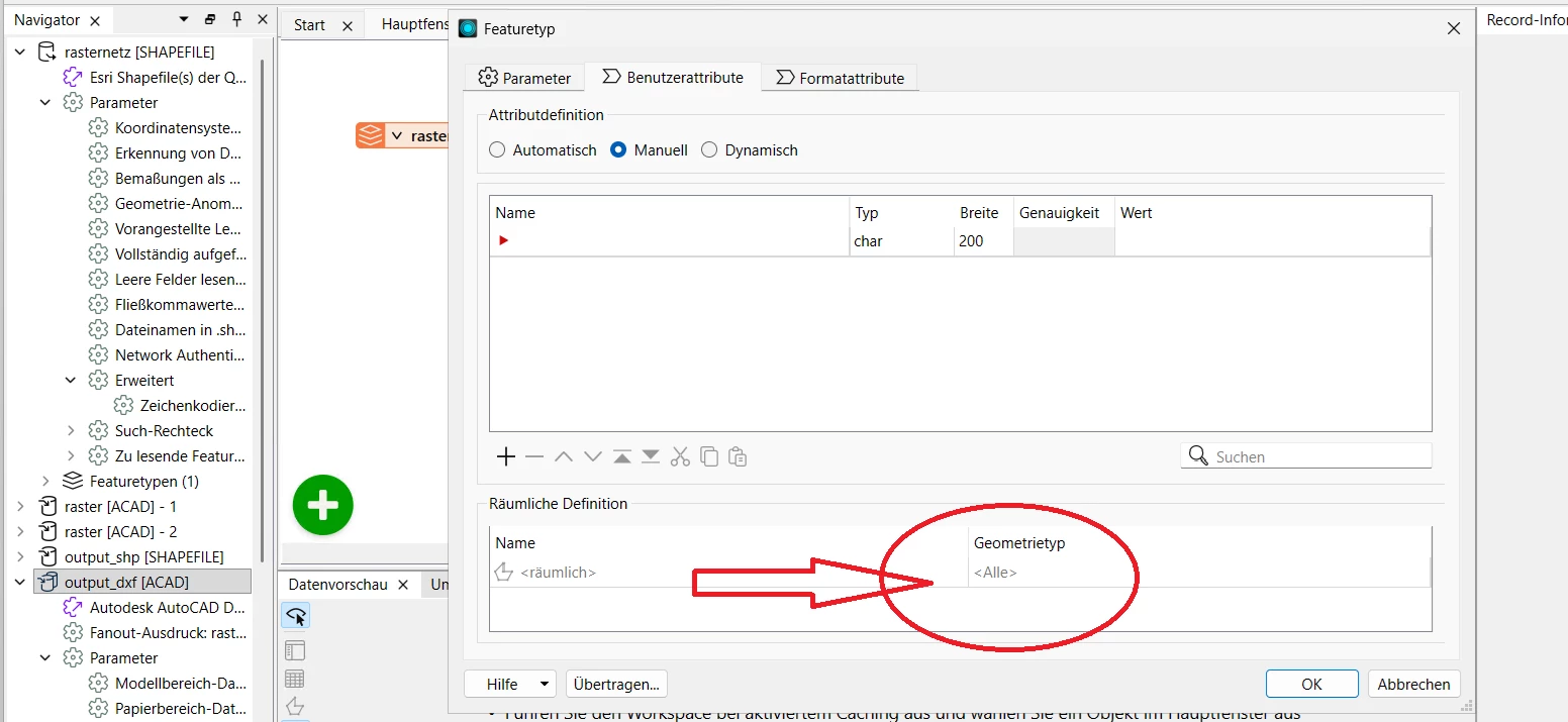

One weird thing is: It is not possible to set the dxf-geometry to “Line”? (Is has only the attribute “all”)…

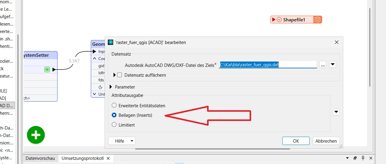

Best answer by kaibehncke
I found the solution.
If I use “Inserts” (for the attributes) if works nice. I can visualize it now also in QGIS.
