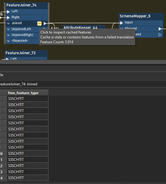

I am still testing at the moment, so feature cashing is enabled which is why I could pinpoint exactly where the entries went missing. In this case it looked something like this:
FeatureJoiner (inspect cashed values: fme_feature_type has entries) outputs into SubstringExtractor input (inspect cashed values: fme_feature_type missing)

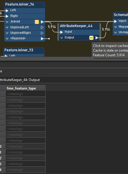

I am not sure how this could be data related as there is nothing else happening between the two transformers, but maybe I am missing something. Will surely do some further testing. Just now I was able to produce the error once again.
This is the FeatureJoiner Output (only fme_feature_type column shown)
And this is the AttributeKeeper which comes right after
