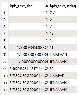

The file has 12 features where igds_type = igds_text. 4 of these features have really large idgs_text_size. I’m not sure why but that is what FME is displaying.
I can’t check the file with the native software but I suspect that it is either large in the original file or something is getting wrongly translated when FME reads the file.
If I were you I would check the text size in the original, and if you can’t find anything, open a supportcase with Safe. Don’t forget to attach the file.

  • Jun 30, 2026 1:16 PM UTC
