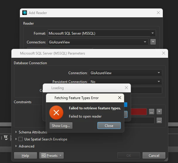

I have installed 2025.1 and the first thing that I can see is the reader format has changed
I would use “Microsoft SQL Server Spatial” in 2022 but in 2025 it is “Microsoft SQL Server (MSSQL)”
I would assume they have aggregated both non-spatial and spatial into one reader format.
I go to add the connection that we normally use - in this case it is called GisAzureView which is a hosted server for us. I would then need to select which tables I would like to read from but I get this error:
2025.1 Error when reading hosted SQL database
“Failed to obtain any schemas from reader 'SQLSERVER' from 1 datasets. This may be due to invalid datasets or format accessibility issues due to licensing, dependencies, or module loading. See logfile for more information” - is the error that comes up - so it is failing to open the reader

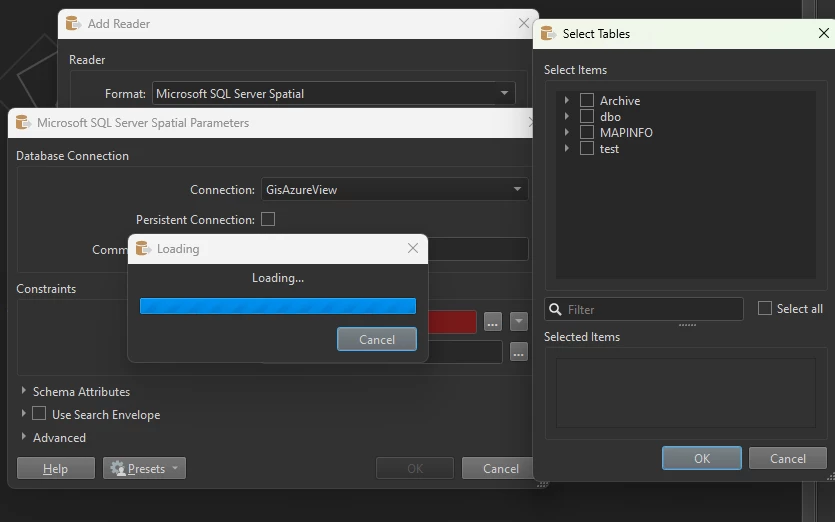

Let’s try 2022.2 again to make sure it is not just my laptop:
FME 2022.2 working
So it looks to be working fine in 2022.2 - I can add tables and run them in 2022.2

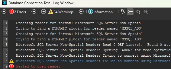

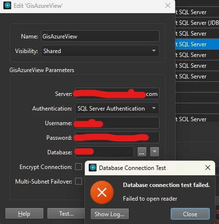

Let me go to the database connections to see what is going on in there:
Microsoft SQL Server Non-Spatial Reader: Failed to connect using Microsoft OLE DB Driver 19 for SQL Server. Provider error '(-2147467259) SSL Provider: The target principal name is incorrect.'. Connection string 'Provider=MSOLEDBSQL19;DataTypeCompatibility=80;Data Source=*********************.com;Initial Catalog=*******;Use Encryption for Data=false;User ID=********;Password=**************************'
The “*” is where the details needing to connect are - I have just wrote over it

crystalwang
Forum|alt.badge.img+31
Hi ​@ieuanam,
Apologies for the late response on this post. I understand you’re encountering some issues with FME 2025.1 failing to read from a hosted SQL Server. This issue is currently being tracked under FMEENGINE-88377 and our development team is actively working on a fix. Thank you for your patience!
