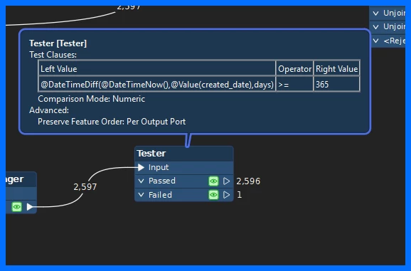

I have an AGOL feature layer with a DateOnly field that I am trying to filter out the last 365 days worth of data. Is there an easy way to complete this?
The data is formatted in the following way:
2021-01-01
Best answer by crutledge
Hi ​@brittzucchetto
You could use a tester or filter and use the DateTimeDiff() function to calculate the time interval in days and then filter greater than / less than 365.
Hope that helps!

Hi ​@brittzucchetto
Hope that helps!

Hi ​@crutledge,
I ended up using this exact approach to solve the issue! I’m glad I was on the right track. Thanks for the quick reply!
