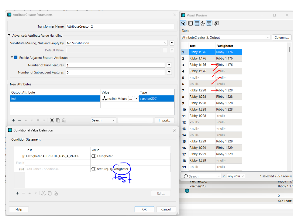

I am trying to fill in the rows of my table with the previous values. I saw this thread and I am following the instructions but for some reason I am only getting the first empty row to be filled but not any subsequent rows.
I tried to change the Subsequent Features to another value other than 0 and even tried to change the number of Prior Features but I always get the same results.
I am on FME Form 2024.2.0.0 if that helps.
Any suggestions as to what I am doing wrong?

Hi ​@norris From what I see, if you are trying to fill the <nulls> in the “test” column you could replace .fastigeter with .test
The way I read the example you have the red lines are what is being written from Fastigheter to test
Hope that helps.

The workbench does what you have defined.
I think,
else   feature[-1].test
delivers the desired result.

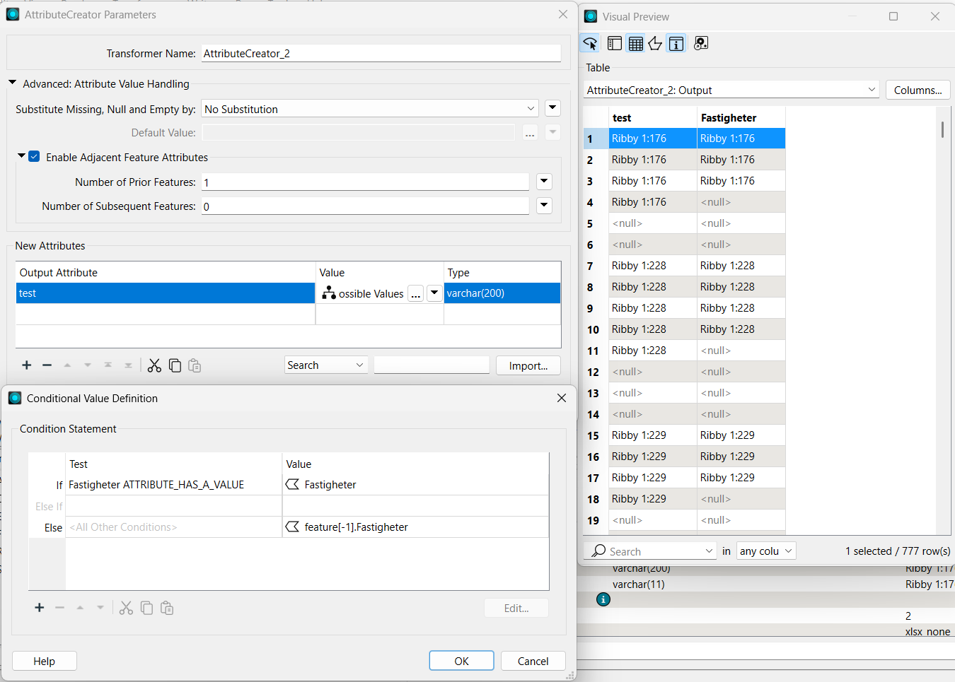

norris
Forum|alt.badge.img+3
  • May 9, 2025 1:54 PM UTC
Hi,
Thanks for the suggestions ​@crutledge and ​@tomfriedl
Apologies for not being clear in my original post. The screenshot to the right (in my original post) is what i get as a result from the AttributeCreator as I created a new column called “test” in the AttributeCreator. The “input” is the column “Fastigheter” and what i want is the column “test” to contain the filled row values.

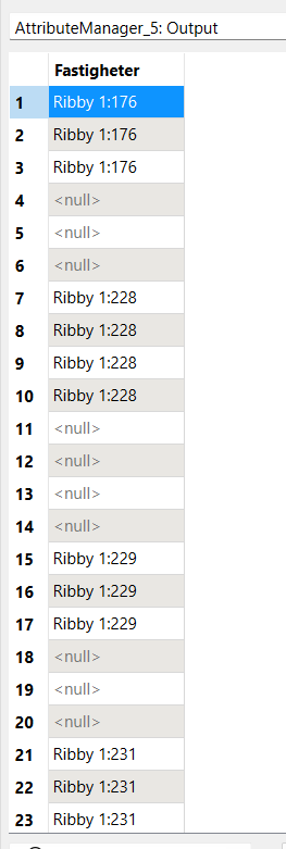

Here is what the input table looks like (just dummy to test things)
here is what I wanted to do with AttributeCreator (but did with Python)
I did manage to get my desired result with pythoncaller but it would be nice to know how to get it to work using a transformer.

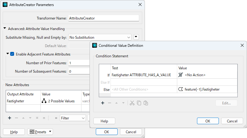

takashi
  • May 9, 2025 2:51 PM UTC
Hi ​@norris ,
If I understand your requirement correctly, I think this setting  works as expected.
norris
  • May 9, 2025 3:10 PM UTC
Thank you so much ​@takashi This worked perfectly!
