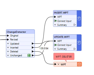

No sure why the Unchanged port is being connected to UPDATE.WPT ?
Sometimes your feature cache can become stale, and the schema isn’t presented to the feature writer. I suggest using Run entire workspace… or in 2026.1 or newer it should warn you if the cache is stale
 Green = good, Yellow = stale
If you made changes to schema, be sure to open FeatureWriter - user attributes
  • if manual remove and re-import the destination table…
  • simply toggle the automatic definition

Also: why FeatureWriters for Inserted and Updated (and Unchanged….), but a regular Writer for Deleted? Much simpler to use the fme_db_operation in a single FeatureWriter or Writer. Since you don’t do any processing after the ChangeDetector, that would be the most elegant option in my opinion.

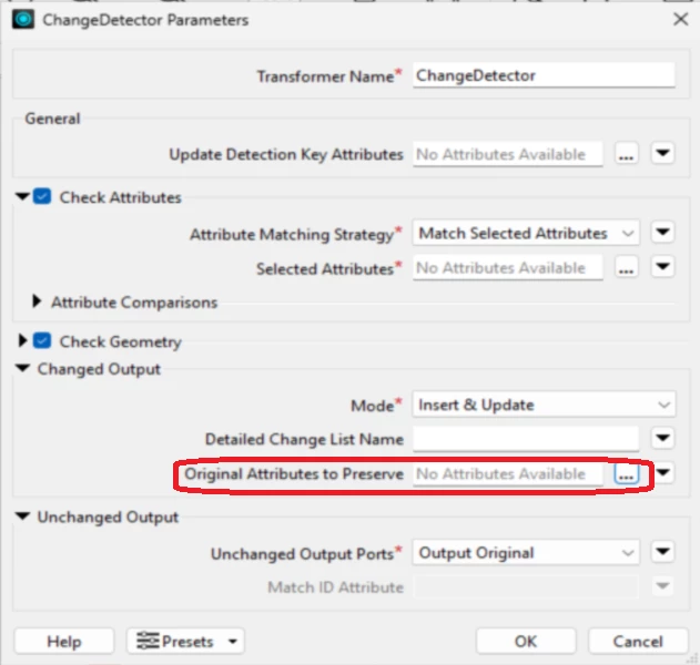

Secondly: What are your settings for Original Attributes to Preserve?
