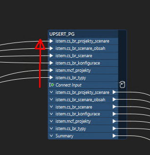

How to securely achieve the desired order of in which are feature types (tables) written in the database? I have some FK dependecies in the target tables and I have somehow discovered that its written from the bottom to the top of the feature types list. If its not written from the parent to the childs it crashes on FK violations.
I know there is an idea registered. But so far what are the options? It consider the inserts/updates and also deletes where i would need the inverse order.

This is more from observation than from technical documentation, but FME uses workspace optimisation that tries to purge Features held in memory as early as possible by finalising their output to a Writer.
This optimisation will lead to some Feature Types being written in a different order than what is ordered within the Writers or within a FeatureWriter and is dependent on which workflow pathways FME feels it can resolve and finish with “first”.  Your example of going from bottom-to-top is coincidental, in my experience, it can happen in any order due to the above memory usage optimisation techniques used by default.
Some strategies are explained here and similar to what I have generally done, by using things like separate Writers for particular Feature Types, or Transformers that block things from writing until say all features that are needed are present (say into the Input Port of a FeatureHolder) or similarly using a FeatureJoiner that in its behaviour won’t allow anything on the LHS to be output to a downstream writer until all RHS features have been received, or Sorters to block writing and prioritise the order of write within a Writer.

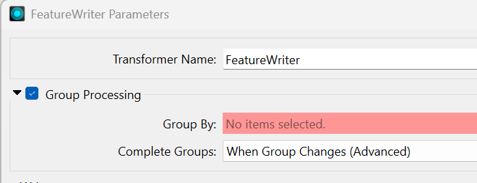

If you have a common identifier that links the parent and child features, you can use it as a Group By in the FeatureWriter. This will ensure that the parent and child records are written in a single transaction.
However, be aware that this will require more available memory, as FME will have to cache all the records in memory before writing them. You can mitigate this using the “Complete Groups = When Group Changes”, but it will require that your features arrive in the correct order to avoid problems.
Check the FeatureWriter documentation for more details.
