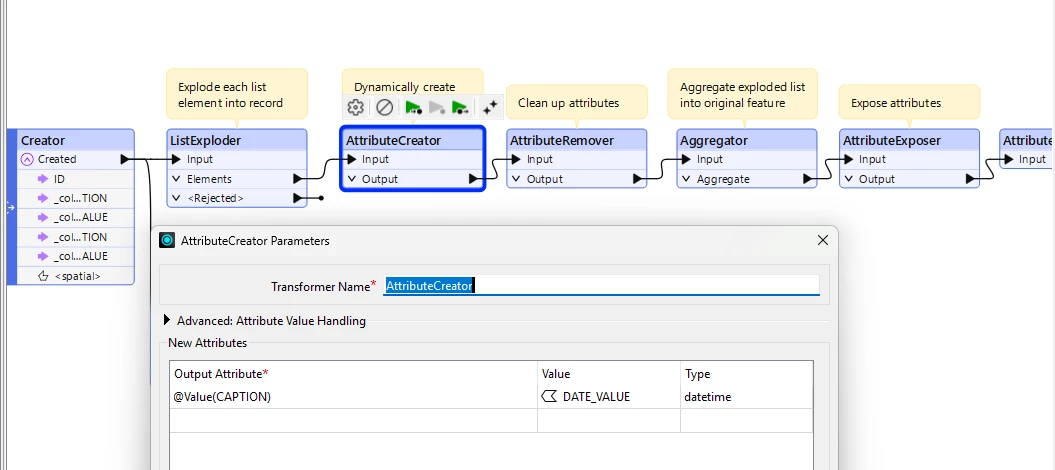

Hi ​@mickbreen! It sounds like you’ll need to dynamically create attributes.
There are a few ways to do this in FME. One way would be to use an AttributeCreator after exploding the list. The values in CAPTION would be new Output Attribute and your date value would be the new attribute’s value.
After you can then clean up the workspace to get something similar to the table you showed.
Alternatively, you could also use an XQuery expression. Here’s a workspace that should help! 🙂

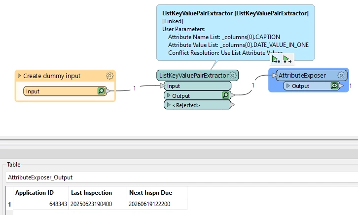

You can also use transformer ListKeyValuePairExtractor from FME Hub, followed by an AttributeExposer.
