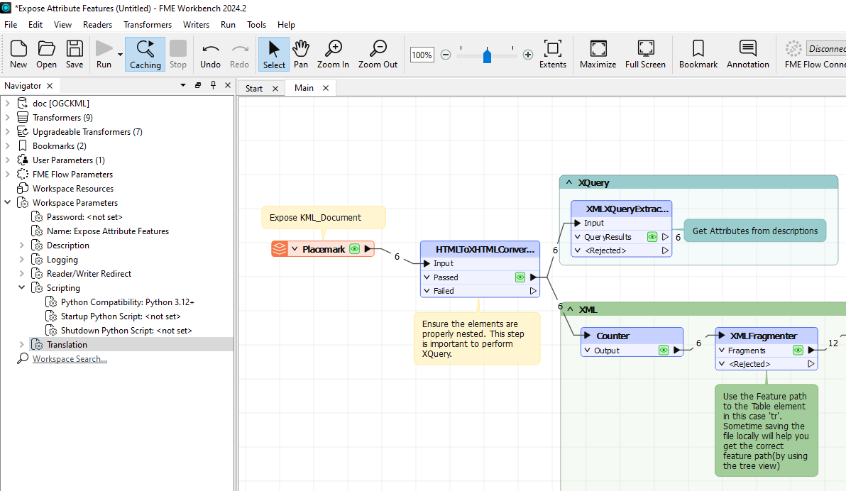

Hi,
I have error while running the workbench from How to Expose Feature Attributes from KML Tags or HTML Tables – FME Support Center
It failes at point Method 2: XML> 2. Fragment XML
Any idea why it does not work. I have not changed any of the settings in that workbench
Best answer by marta.podsiad
It looks like there is a bug in FME 2024.0. I have run the same workbench with older version and all workded as expected

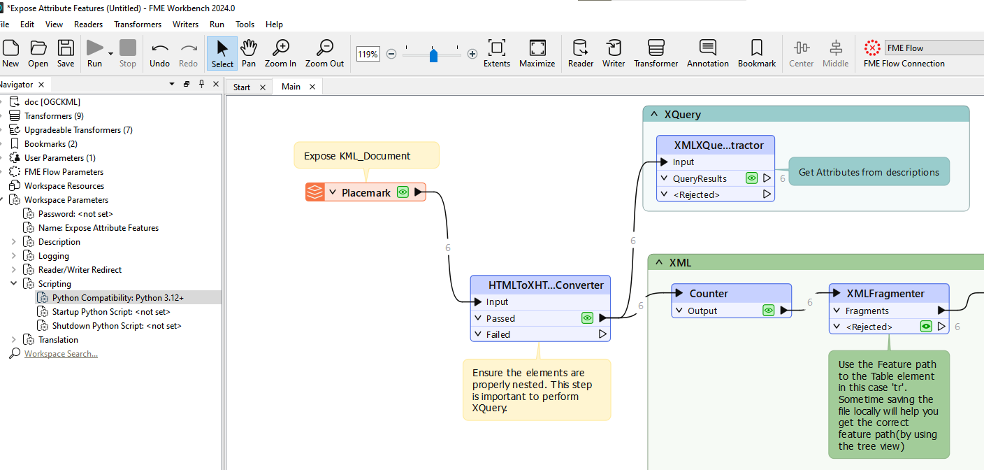

Hi, I am running the workbench that is saved under this link How to Expose Feature Attributes from KML Tags or HTML Tables – FME Support Center

2024.2 gives me no issues. I see you use 2024.0. Not sure this is the issue, but in general I would not advise to use .0 versions for production work.

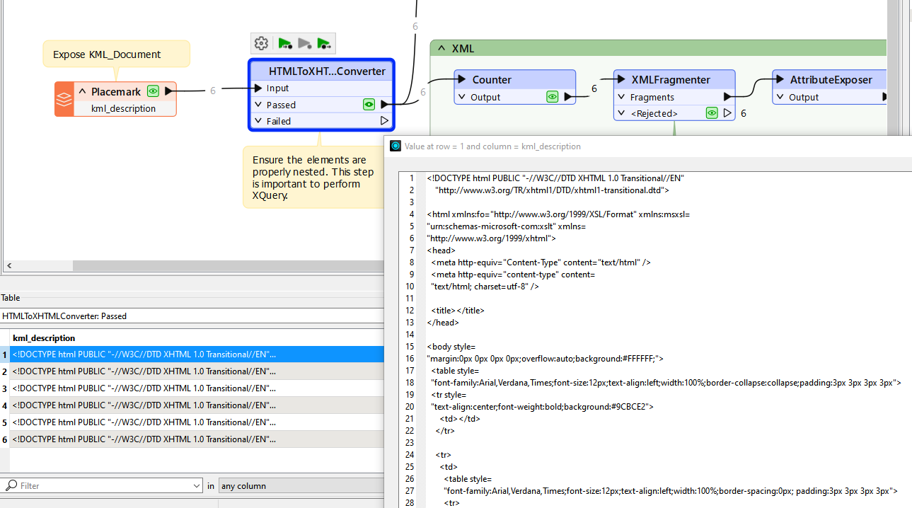

what should the text look like in HMLToHTML Converter?
