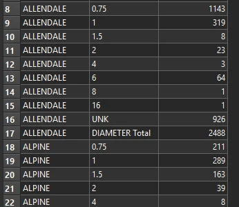

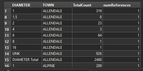

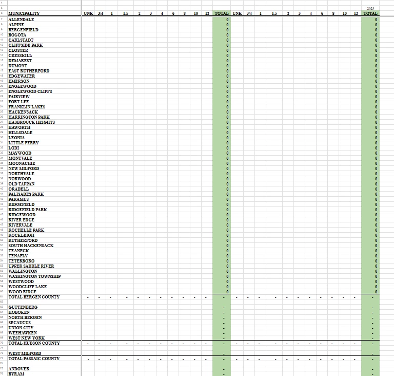

I’m working on trying to automate some of my company’s reporting, like the one partially shown in this screenshot. So far, I am able to get pretty much most of this information through to the Attribute Pivoter, but I am pretty new to getting this information properly into a Google Sheet. I have the Customer side (left side) and Company side (right side) going through separate channels because they’re from different layers...and I’m starting to wonder if it’s even possible to populate this information in this way from Attribute Pivoter or if I should just switch to separate tabs within the Google Sheet. Second screenshot is what the attribute pivoter summary results look like for the right hand side which is essentially what I want...just not broken down the way I want.

There is a way to proceed from you post AttributePivoter point. Assuming the data is as shown in the second screenshot:
  • Place a AttributeCreator. Have it make an attribute based on the attribute value of the second column. (I am going to assume there are no weird values in the second column), with the value of the third column
  • Sample the first row of each municipality with a Sampler. (Group processing on the first column, Sampling type set to First N features. Leave Sampling rate at 1)
  • Follow it up with a FeatureMerger. Connect the Sampled port of the Sampler with the Requestor and the NotSampled port with the Supplier. In the settings of the FeatureMerger, Join on the First colum and make sure Process Duplicate Suppliers is checked.
  • You should now have a single row per municipality with the correct columns.
  • Expose the columns with a AttributeExposer for better visibility and operational options.
  • Assume this is one of the datasets (Customer or Company), do the same for the other dataset.
  • Merge both datasets with a FeatureMerger or FeatureJoiner and fix attribute names with a AttributeManager.
  • After that you can start writing. It might be possible to use an empty template as shown in the first screenshot, but that depends on the format.
There might be another way to do this but that requires us knowing how the data looks like pre pivoting.
Good luck!

Hey! Thanks for the response...I tried that process and it still isn’t working. This is what shows after the feature merger...and for some reason all 0.75 diameter values are gone.

To add further context, the first column in the second screenshot of the original post the columns are TOWN, DIAMETER, and TOTAL.

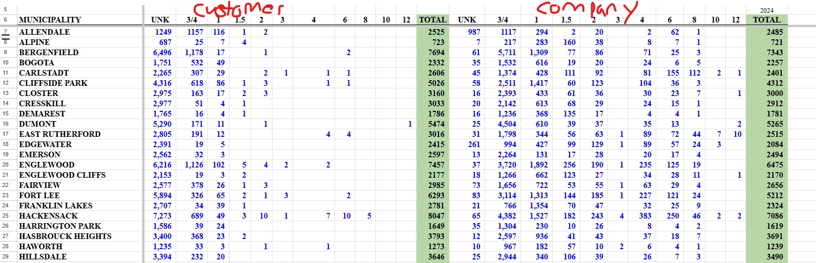

Hate to ask you another question, but do you think it’s possible to get both sets of data (customer + company) into the same spreadsheet using template formatting? I have a feeling it would be very annoying or difficult…please let me know if you have suggestions. Otherwise, I may just change it to be separate tabs for each.

  • Feature merge the company and customer datasets with a FeatureMerger or FeatureJoiner based on TOWN. This should place both tables next to eachother like you last screenshot.

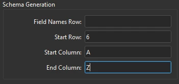

  • Add the Google sheets Writer. You will have to fill in the connection and Spreadsheet Name/URL yourself. However Schema Generation should be something like this:
  • You will need to test this yourself, but I think it will start writing the data from row 6 and will not write down the attribute names.
