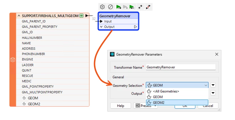

It was an intentional decision to set ‘Handle Multiple Spatial Columns’ to yes by default and to remove the option from the interface, so we’re always reading in all geometry columns. This decision was made to be consistent with our other database formats such as Microsoft SQL Server.
In order to know which geometry column you’re working with, you’ll need a GeometryRemover transformer, and it’ll allow you to choose which geometry column to remove. If you have three geometry columns, you may need a second GeometryRemover.
I found this article really helpful to get acquainted with how to interact with the multiple geometry columns: Writing to Database Tables that contain Multiple Geometry Columns - 2026.1 and newer
