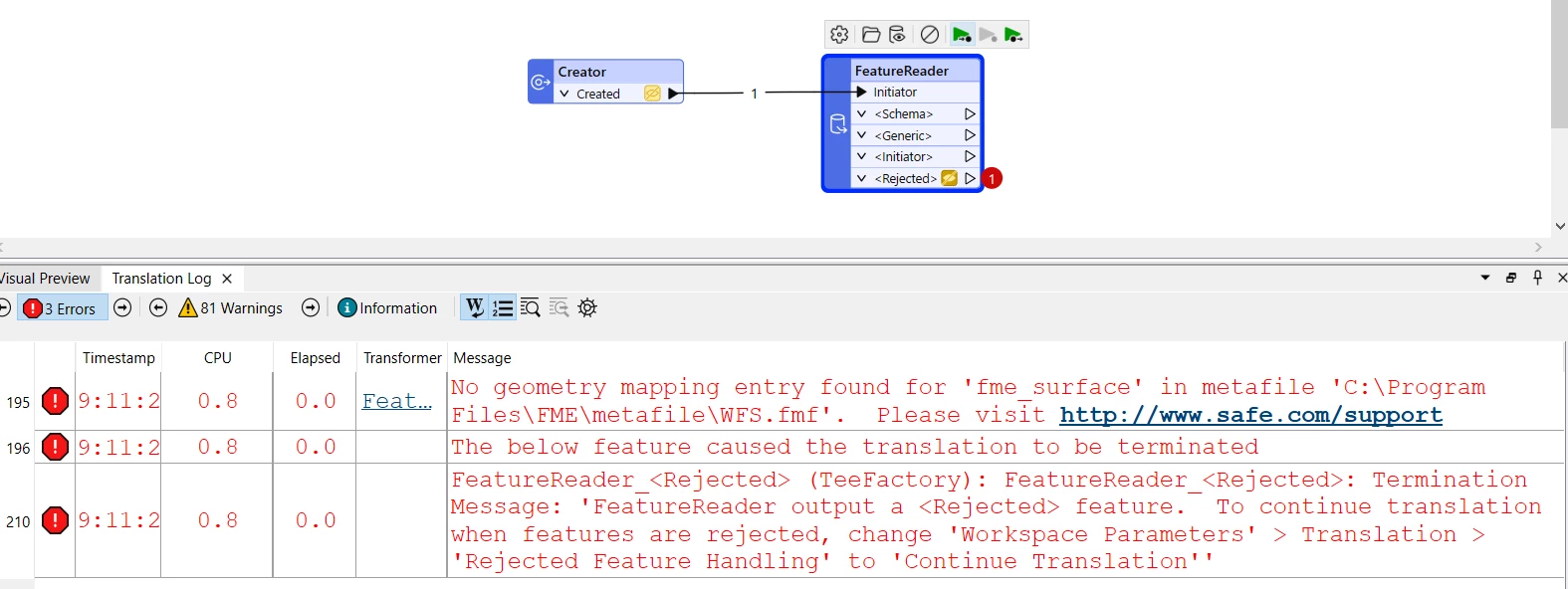

This morning I tried to import data using a WFS concerning a Dutch data source. I got into a weird error:
Used WFS:Β service.pdok.nl/kadaster/kadastralekaart/wfs/v5_0?request=GetCapabilities&service=WFS
Does this look familiar to someone?

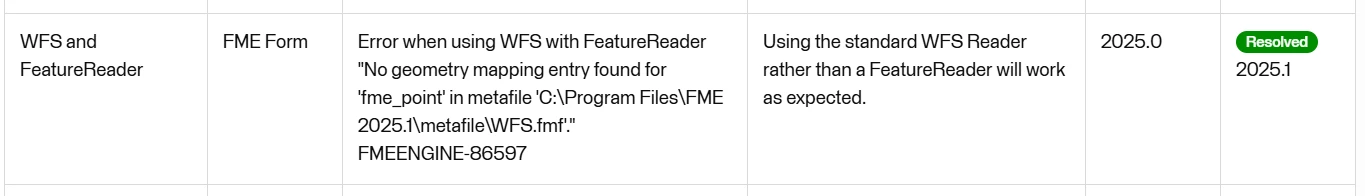

Best answer by lambertus
I found that this issue is a known bug for my FME version 2025.0
Known Issues in FME – FME Support Center
..ICT departement is on the way with new update 2025.1Β πŸ˜€

Works for me just fine using FME version 2025.1.2 & WFS version 2.0.0.
itsmatt
Forum|alt.badge.img+48
  • Oct 1, 2025 7:32 AM UTC
I also had no issue in FME 2024.2
Are you using a spatial filter at all? I was able to read the first 1000 features from each of the 5 layers without a spatial filter. Just the default null features from the Creator.
