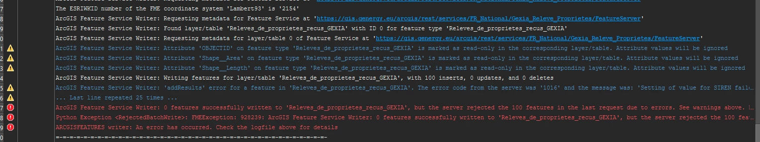

Hello ! I try to write into my feature service.
I got an error wich say “The error code from the server was '1016' and the message was: 'Setting of value for SIREN failed.'”
I try to write into my feature service but I got this error. The attribute type into “User Attribute” is the same as into the feature service.
When i run the writer, the script “failed” but I got some result into the feature service. At the beginning I was thinking that was my SIREN attribute wich broke everything. The error “1016” is not an usual error (for me) and I dpon’t find any advice about this error.
In the attribute manager just before my writer, everything is allright (except OBJECTID) but at the end I got this error =>
Every help will be gratefull ! Thanks a lot !

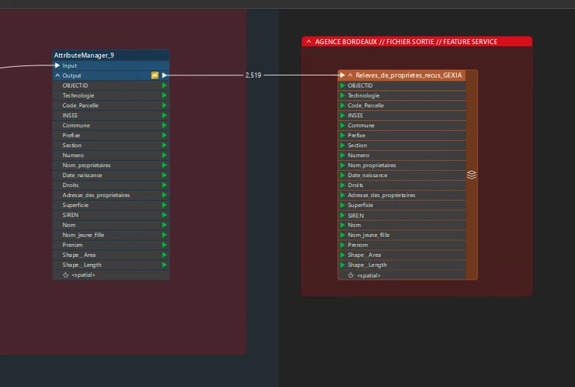

I use a attribute creator to create a new attribute with the name “SIREN_NUMBER” with a type “Int32” because i got a 9 number long. Next in the attributemanager I just rename this attribute into “SIREN”. I do test and I tell you if it works.

So i use a tester to divide the data between the one with a SIREN number and those without SIREN Number. When i send the data without SIREN to the feature service Writer, the Translation was SUCCESSFUL.
So I try to understand where is my problem
In the READER my SIREN Type is STRING
So now I know that my SIREN type are not OK but into my featureservice the data is
I use a attribute Validator just before the WRITER and my SIREN data are still in STRING.
So I turn the problem differently and I just change into my FeatureService the type of the attribute SIREN into Varchar(255) and now it work !!
