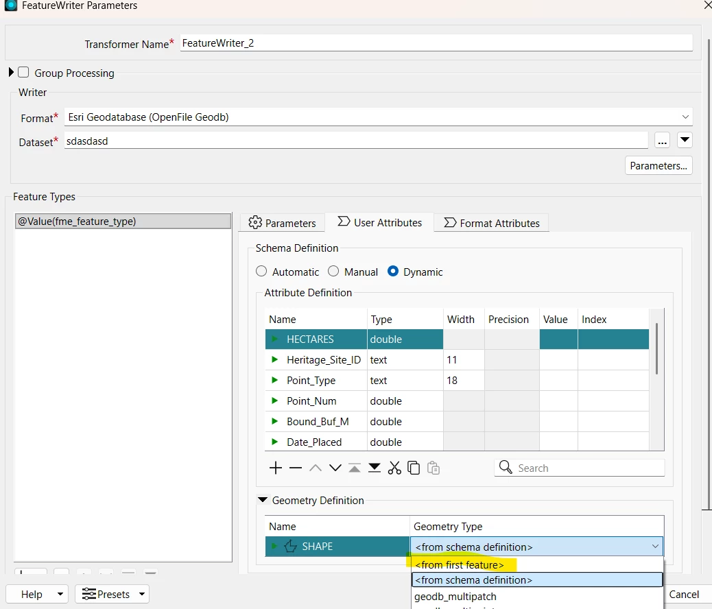

Due to changes in FME 2026.1, with improved spatial discovery through the Spatial Definition Table , you will notice the following:
  • Readers and Writers have been updated, with geometry and coordinate system parameters now located under the User Attributes tab.
  • Reader geometry definitions cannot be modified, as they reflect the source data.
  • Traditional Writing - To control Writer geometry output, use a GeometryFilter (or equivalent) upstream of the Writer feature types, and route the outputs to the appropriate feature type(s), or consolidate multiple inputs into a single Writer as required.
  •  Dynamic Schema Writing - you specify Dynamic Schema on the writer parameters then under the user attributes tab, you will find two options 1.) from First Features 2.) from schema definition
Geometry Definition now under User Attribute tab

Hello, thank you for the reply. I tried changing the Geometry Type in the writer like you suggested, but it’s still resulting in ZM features. Is there any other way I could try forcing the writer to output 2D features, or will the combination of a dynamic writer with the OpenFile Geodb format always result in 3D features?
