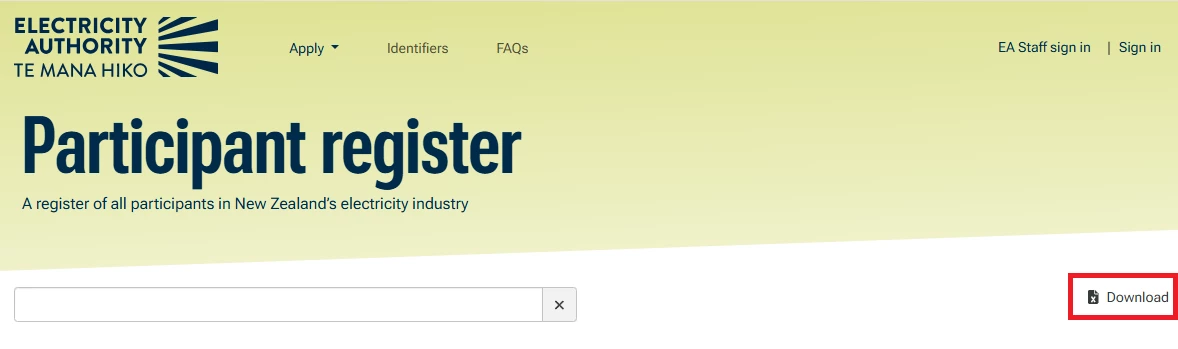

Hi,
I’m looking for solutions to a problem that may not be solvable.
I regularly need to refer to a spreadsheet from the NZ Electricity Authority (it’s open data).  At the moment I have to regularly download it from https://register.ea.govt.nz/ using the ‘Download’ button
This downloads a dynamically time-stamped spreadsheet of the electricity industry participants and their relevant codes.
I want to automate this with Form/Flow but this is a sticking point.  I’ve suggested to them that they expose this as a service for the industry, but the wheels move slowly if at all.
Any idea on how to read, or more likely, automatically download this?  For the download I’m open to non-FME automations.
Thanks
Best answer by hkingsbury
All that link is doing is making a call to “https://register.ea.govt.nz/download?”
You may be able to replicate the call in the HTTPCaller, you may need to adjust some of the headers to pass through what the end point is expecting.
You can find these using your browsers developer tools

That works.  Thanks Hamish
