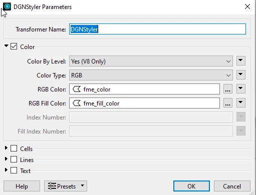

  1. I have a dgn styler configurated as follows

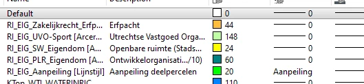

  3. Output is
Am I doing somethign wrong or are true colors not yet available in FME 2024.2.1?
