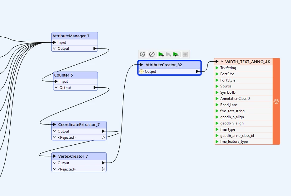

My task at work is to extract text from DGN files and convert it to Annotation Feature classes in a GDB. I need to override the FontSize value that comes from DGN with a specific value in the GDB Annotation class, and all my attempts failed. Does anyone have suggestions on how to go about it? I am using FME 2024 and ArcPro 3.5. Thanks!

  1. You must explicitly set geodatabase annotation attribute
  • geodb_text_string → the text value
  • geodb_text_size → text size
  • geodb_text_x_coord, geodb_text_y_coord → position
  • geodb_text_feat_class_name → destination annotation class
2. You might want to try the transformer LabelPointReplacer
and the output connection goes into a writer, where in FME2024 writer parameters there is a geometry dropdown for geodb_annotation. In FME2026 they have moved this to the User Attributes tab…. strangely..

I used the first option.
I also added the geodb_allow_symbol_overrides attribute to my Attribute Creator list and that did it.
