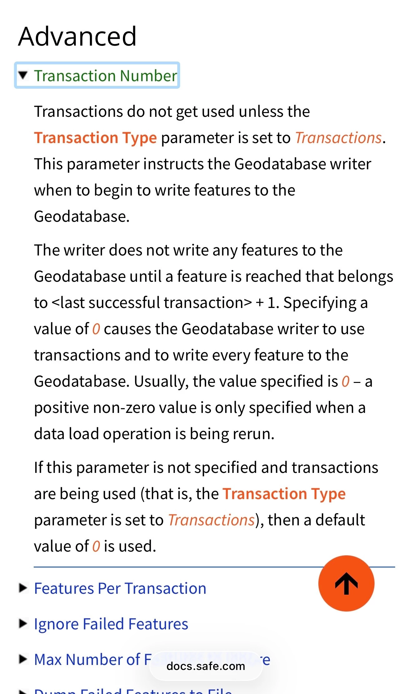

Best approach might be to look how you can use the advanced parameter options, commit frequency … or explore the transaction type = transaction and find a way to use the count attribute you created from modulo
