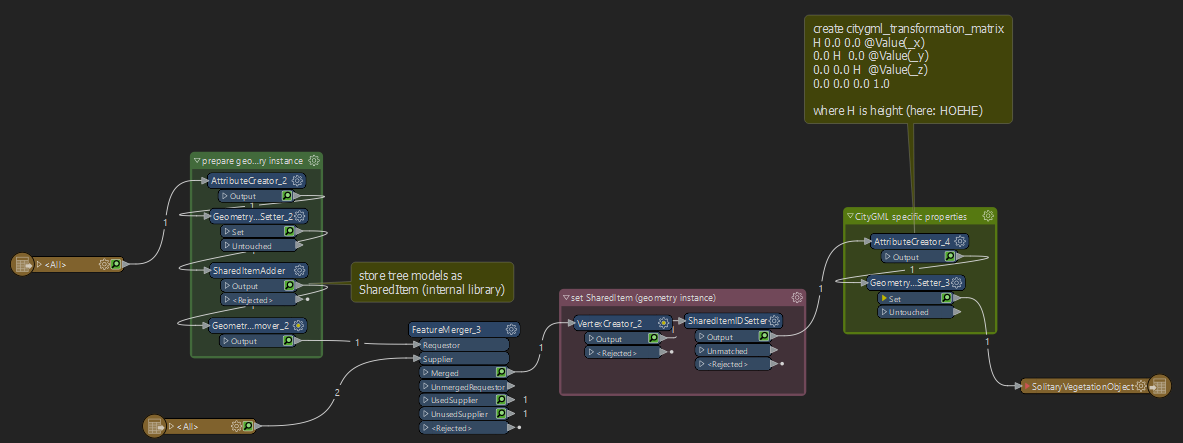

I am currently working on the conversion of FBX tree model to CityGML SolitaryVegetationObject. I have made reference to the template workflow for creating SolitaryVegetationObject (ref: https://hub.safe.com/publishers/con-terra-lab/templates/citygml-create-solitaryvegetationobject-with-implicit-representation). However, my case is slightly different from the template.
First of all, what I current have, is a CSV file containing the tree information (XYZ, DBH, etc) and an FBX file containing one 3D tree model with correct transformation and dimensions (DBH). This FBX file was originally a prototype in FBX format and was transformed into a correct XYZ and DBH. Since not all my data contain crown spread and tree height, they would be estimated by scaling from the prototype with reference to DBH. This estimation would not generate a value for the crown spread and tree height but only a dimension change. What I want to do is to convert this FBX into a CityGML file, appending the attributes from the CSV. The targeted geometry for the GML file is Lod2ImplicitRepresentation according to the OGC CityGML 2.0 standard. I also noticed that writing a Lod2ImplicitRepresentation would require a library, so I created a library in the workflow. Therefore, with reference to the template workflow above mentioned. A workflow is proposed below.
However, this workflow generates no output in GML format. The last output stopped in the GeometryPropertySetter (The last transformer).

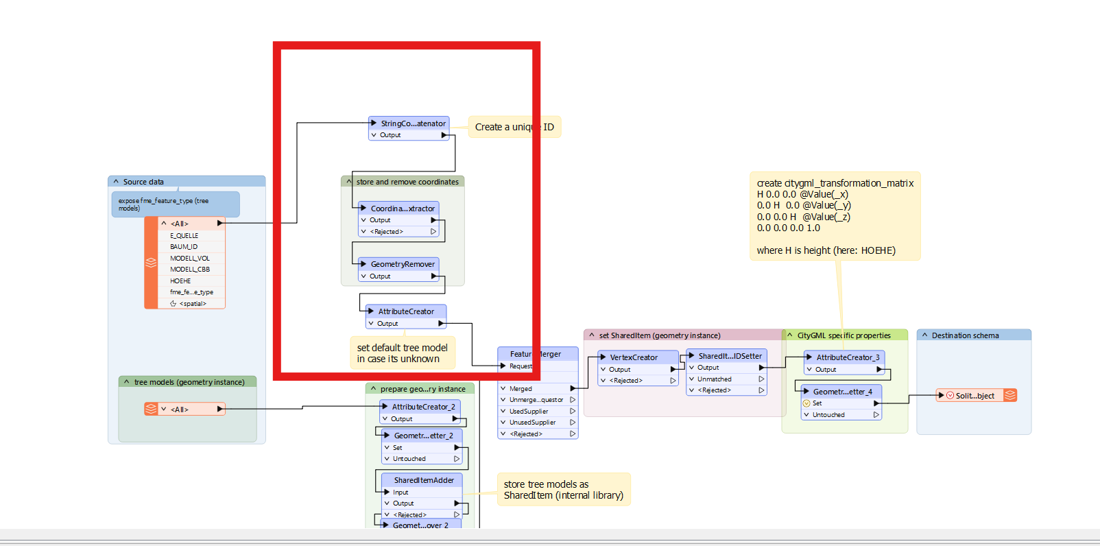

Why did you remove this part?
You need to store the x,y,z values so the transformer matrix works.
Otherwise I had sometimes cache problems due to the id setter, so I always had to run it without cache.
Have you tried running the provided workspace with the default data? Does it create a gml file then?

First of all, the default data did generate a GML file for me. But as I mentioned, my case is slightly different because the tree is already transformed in its source format. The XYZ value already exists in the CSV file so I did not conduct the coordinate extraction. Besides, my tree model does not have the tree height value. The tree height was generated based on the estimation of the original prototype. Therefore, I have tried two approaches, first to remove the transformation matrix and replace some other random field, second to make up a tree height and input as an integer directly into the matrix. Both did not give any output.

Then you can simply replace the light green bookmark with a “CityGMLGeometrySetter” and use the x,y,z values in the vertex creator (if you arent already).
If the csv doesnt provide a unique id, you should create one and if it does you should rename it to “gml_id”

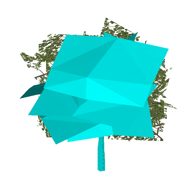

  2. My GML file looks very strange in GML geometries. Is it the problem of the FBX geometries? Is there any way to fix it?
CityGML model appearance
Original appearance of the model

Are both odd looking trees on the same coordinate or are the locations correct?
The model looks fine, it’s the texture that’s messed up. Try it with one tree, then we know if it gets confused by the id-setter.

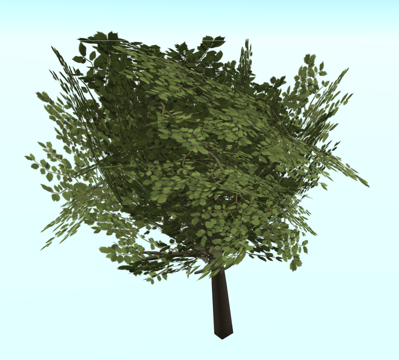

I have some findings regarding the texture. I have only one PNG as texture and my model has two parts, one is the crown and another is the trunk. The <app:X3DMaterial> part referenced to both parts of the model separately while the <app:ParameterizedTexture> part only referenced to one part of the model, leading to an incomplete texture. Is there any cause to this problem and is there any way to fix it?

The tree model conversion is ok. The remaining issue is the texture. I followed the inspector on each step in FME. I could not observe any problem during the process. The texture has been attached to the model until the final output.

I did try one FBX tree model from the link you provided. The result turned out to be fine. The texture was not lost. So the problem should be my source FBX model?

I think I have found some possible reasons for the texture loss. My tree models were separated into two sections, crown and trunk. And I found that only the crown had an image texture. The trunk was only a RGB base color for the material of the trunk. I think it causes the texture loss but I am not sure how to fix it.

Top of my head you got two choices: either work on your model (e.g. set a simple brown texture on the trunk with something like blender) or try setting the images of every part with appearance setter.
