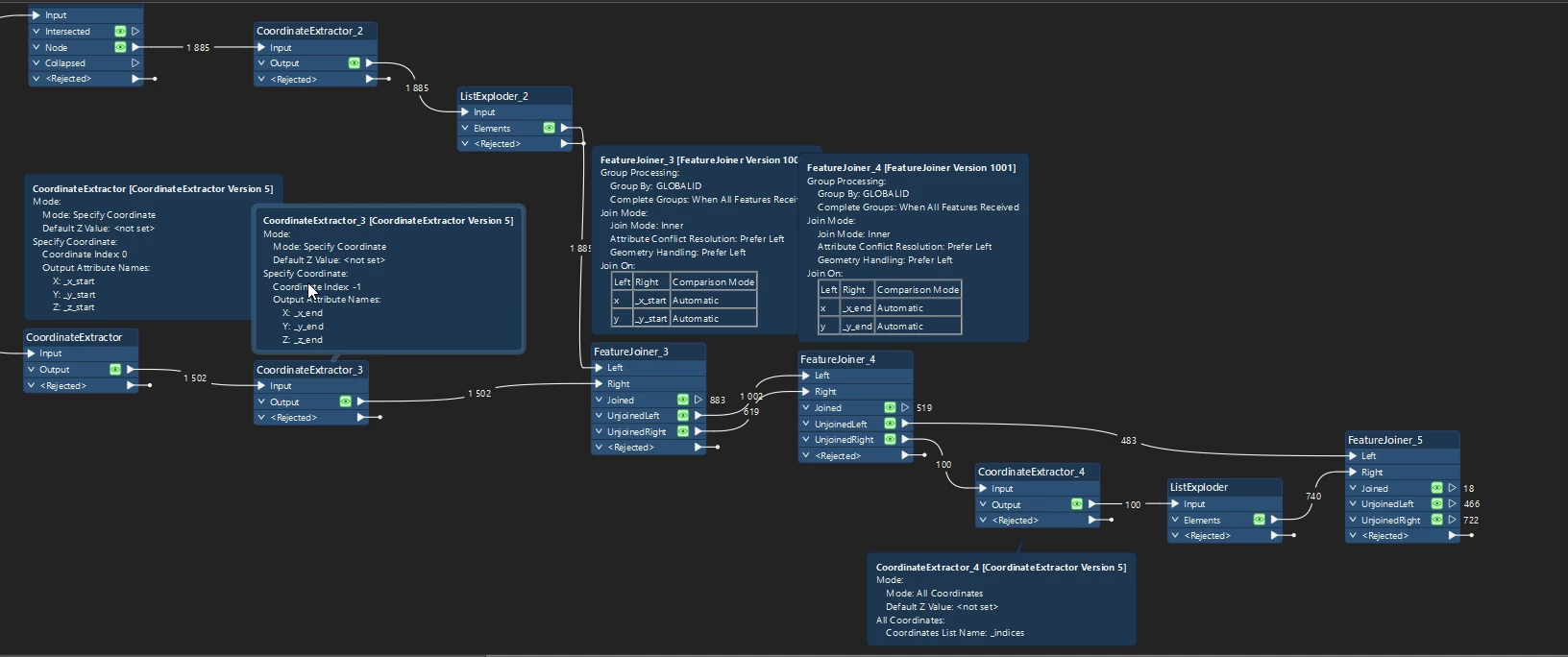

Currently I am using Insector, and to filter out the nodes that share a node between consecutive lines, I cobination of coordinate extractor and FeatureJoiner. Afterwards, I extract all coordinates of the lines and join them again with the remaining points from Insector to identify the real intersecting points, as well as the intersecting points that do not exist as vertices on the line.
Then I gave new z values to this vertex candidate but how can i insert them onto line while preservin their z values which is different than rest of the line

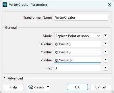

Take a look at the VertexCreator. This transformer can also be used to move a vertex.

​@geomancer I know the transformer. But i dont know how i should integrate into the workflow. I dont know what the index should be etc.
