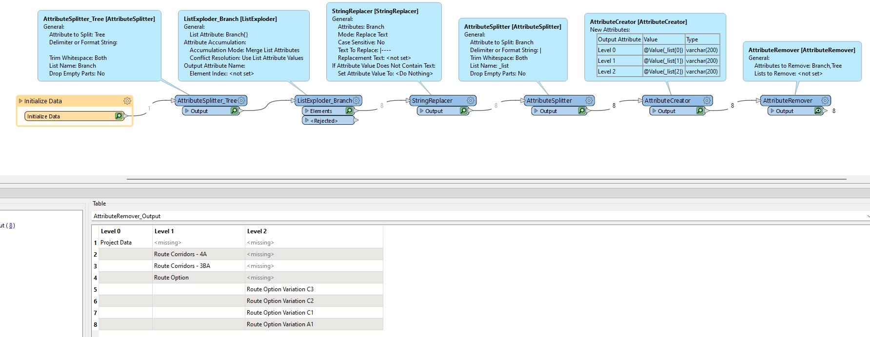

If I understand your question correctly, this may provide you with a start.
But I wonder about the data earlier in your workspace, maybe you can get the data for Excel from there somehow.
