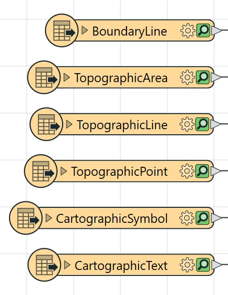

However, the main requirement is that our CAD users have the ability to toggle layers on and off. The following are the Feature Types, from the Ordnance Survey Topography GML download, which are required as layers:
GML Feature Types which are required as CAD layers
and are the ones which our CAD users will want to toggle on and off.
Hope this is OK, but please let me know if you require any more information.
