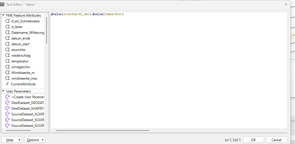

I want to calculate a new attribute using the attributecreator with Text Editor:
But I my results are always the source values:
What is my mistake?
Thank you for your support!
Best answer by max_h
To calculate you have to use the arithmetic editor:

you can embed @Evaluate(...) into the text editor field.   It super handy when you want to calculate an expression in a text block without having to create an attribute first.
Ex.   The temperature delta for the @value(Name) region is @Evaluate(@value(TempHist) - @value(TempActual))
