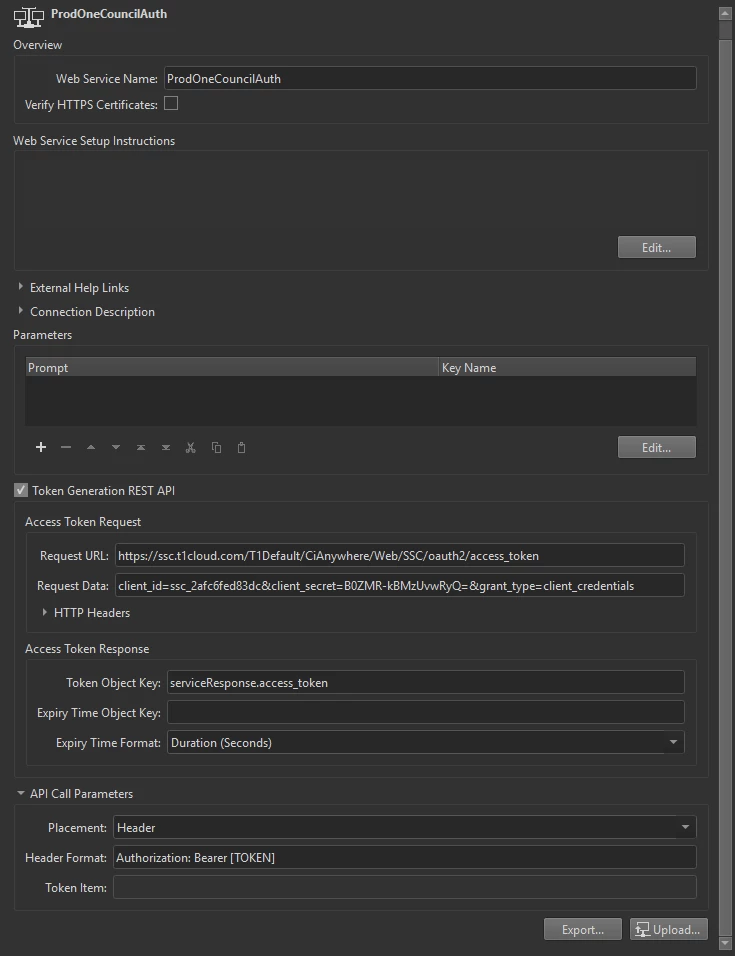

I have a question about how we can recreate a URL call from a token service from an Oauth enabled end point.
The web connection I have works as intended in Form and occasionally falls over in Flow (maybe 1 in 10) and I am attempting to troubleshoot.
To do so I am trying to connect to the web service endpoint by building the URL that the token service creates through the Web services in FME.
Does anyone have a template that can show me where each of the fields are built into a URL call so I can substitute in the values I have in the request URL, request Data, Token Object Key and Header fields?
I am assuming I’ll have to strip out some fields that aren’t needed and maybe use some additional fields that form populates automatically but I just need somewhere to start from.
This is how I have it set-up but not all of the details are in the request data field.

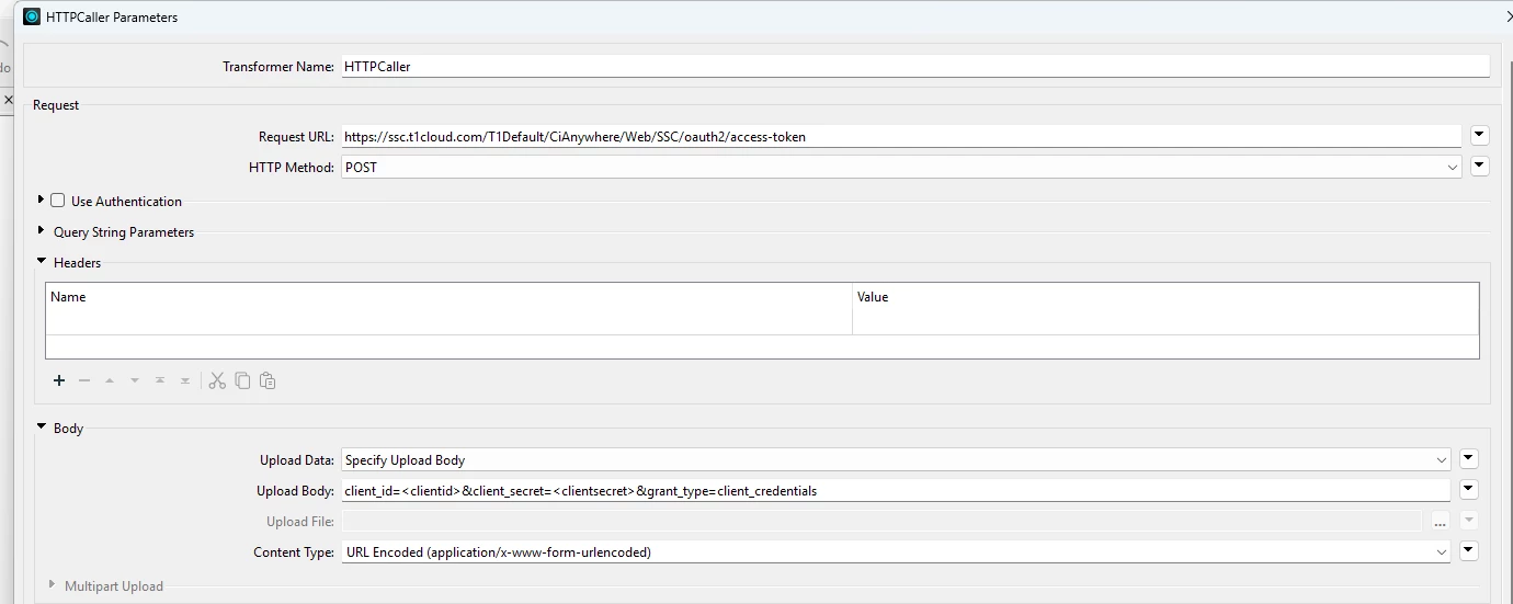

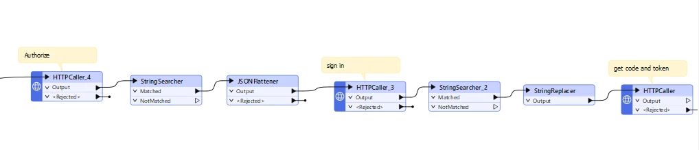

Best answer by todd_davis
I am not completely sure if I am answering your question, but I read it as you are trying to understand what this looks like as a http call. Since it just a token call to get client credentials, and not a oauth2 flow, then it just a simple http call.
If it was a Ouath2 flow getting a refresh and access token, it does get into multiple calls (but this is not required for your example):

  • Aug 23, 2026 10:34 PM UTC

Hi ​@mickbreen!
⚠️ Quick Security Note: Your screenshot shows visible client details in the request field. Even if these are test credentials, I'd recommend rotating/regenerating that secret with your provider as soon as possible and updating or blurring the image in your post.
The workflow Todd shared above is a great template for reconstructing what FME's token web service does under the hood. Web connections send a request to the endpoint with the required payload and scopes, then parse the JSON response to extract the access token for use in downstream POST requests. Keeping the provider's API documentation handy is usually the easiest way to ensure you send the correct payload and that all required key-value pairs are there.

Hi ​@mickbreen, I’ve deleted the image from your post, following up on ​@desiree_at_safe comment.

​@todd_davis workflow will be very useful in another project I am working on and looking to implement some external variables for token requests.
Given the conversation I don’t think I can do what I was originally trying to do as I was trying to build a single URL that I could paste into a web browser and view the endpoint.
The request/token/authorisation/login steps seem to need to be handled separately in an oauth2 workflow.
