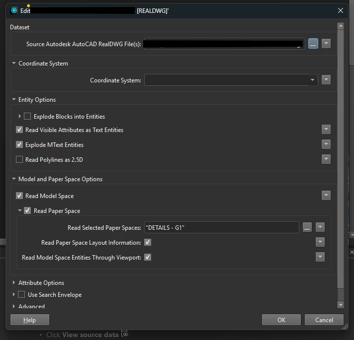

I am trying to validate some properties of objects in DWG files, and some of the things I’d like to check require me to know what paper space viewport an object is visible through, but I have been unable to get the autocad_viewport_handle attribute to show up.
I’ve tried a few combinations of reader parameters, including checking all boxes in the “Model and Paper Space Options” section, unchecking some options while leaving “Read Model Space Entities Through Viewports” checked, and tried reading multiple DWGs, but so far I have not had any luck. I am thinking this must be a “me” problem, but I’m kind of at a loss. Is there a certain set of parameter settings required to get autocad_viewport_handle to show up? I am setting the reader to expose the attribute, but so far, it is always missing. I’m using FME 2025.0.
