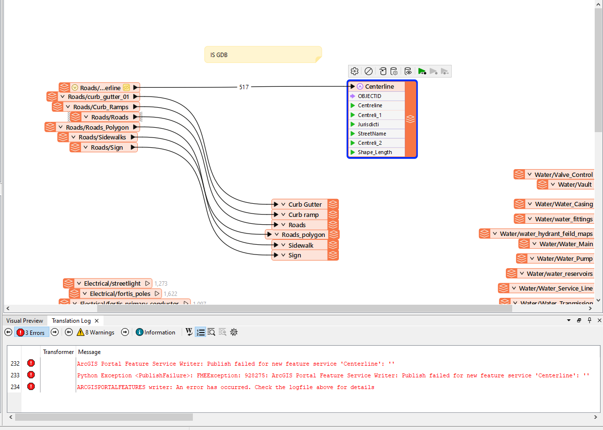

I am trying to set up a simple update workflow that doesn’t like me. I am trying to update my enterprise portal with GDB updates and will eventually want to have this run everyday but for now I am just trying to figure out how to update one shapefile and repeat this 30 times.
Right now I haver set up a GDB reader going directly into ESRi ArcGIS portal feature service writer to update an existing feature in enterprise and I have got it to write the features but it doesn’t want to publish the feature into portal.
Can someone help me figure this out?

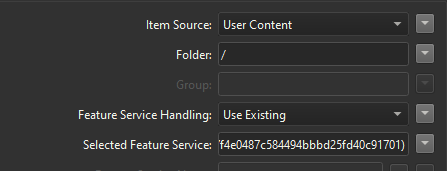

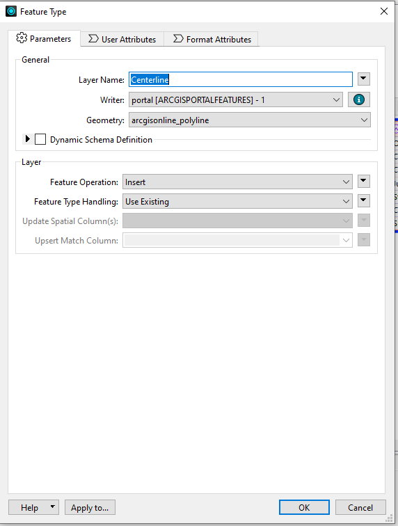

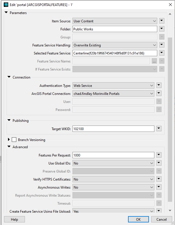

Can you open up one of the writers to share the settings? We can help troubleshoot with some screen captures. Could be data types, field names, insert, truncate etc . Here to help.
cdog
Forum|alt.badge.img+2
  • April 16, 2025

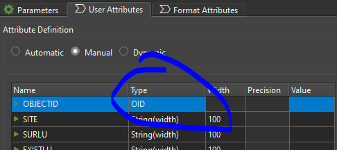

I was having issue with the writer not finding the objectID so I filled it in and that seemed to of worked thus including the above screenshot.

I would try changing OBJECTID to OID and not assigning. OBJECTID is handled by system.
I also wonder if feature exists you may try “Use Existing”
Check Portal if the Hosted Feature Layer still exists. It might have gotten blown away in the process.

I tried the changes but still getting the same error. Its writing the attributes but can’t publish the feature.

Hi ​@cdog So I understand better. There is already a layer in Portal named “Centerline” and you want to push updates to that layer. So keep adding records into that existing layer and keep existing records?”
or
do you want to overwrite the entire layer every time and treat that new but keep the same name?
Sorry if I am misunderstanding. I am sure we can get this solved for you. You might also try to “Start Fresh” and just do the one. I see that there’s a lot going on in the workbench you have right now (screen cap above). Might try just one reader and writer and see if we can get that working for you.

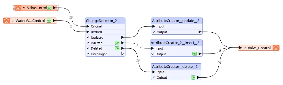

I have started to use change detector to attribute creator to feature writer with a portal reader connected to the change detector as the original and it works, well sort of. No errors but it doesn’t change anything in enterprise. I want to delete some empty fields that I have created from this process and put in the 8 that have attributes but it just runs and does nothing.
I guess my main issue is that its working and it either doesn’t update the attribute table or if it does there are no attributes displayed in it and it just inserts 8 rows rather then updating them with the correct information.
Below is my workflow.
