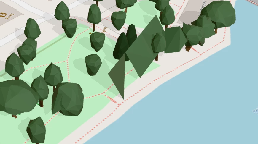

Hi!
It seems like the 3D-tiles writer in FME 2025.2 produces artifacts like the ones below in cesiumjs (version 1.134), where they are not prevalent in basically the same workspace in 2024.2 (everything is the same except for a new writer). Is there any information on why this might be or is there maybe a fix for this in later versions? This problem seem to occur for multiple datasets. They look fine using inspector and in other software, as well as returning no validity errors, as far as we know.

It may be worth submitting a support/bug ticket to Safe along with the workspace (in both versions) and a subset of problem data. They’ll be able to confirm if it is a bug and raise an internal ticket to resolve it in subsequent releases.
