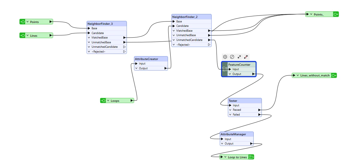

The issue is that I tried to match them using a NeighborFinder, when using the lines as base and points as candidate, I was unable to extract the points after with the missing info filled in. However when I used them with points as base and lines as candidates, I had a lot more lines left over. With a manual loop this amount decreased, so I am trying to do a loop transformer. As this is the first time I am unsure of where I am going wrong. I added a counter to see how many features are left and the tester is than to compare with the previous count, so if there are no changes it should end.

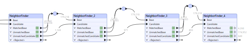

The screenshot below is my manual try of what I had in mind.

Hi ​@lvb,
Without being able to run the workspace directly it's tricky to pinpoint exactly what's going wrong, but here are a few things worth checking:
  • I believe only UnmatchedCandidate lines should feed back into the loop
  • Consider adding a FeatureMerger before your output writer to copy missing attributes from the matched line onto the point
If you're still stuck, it may be worth sharing the workspace so we can take a closer look!
